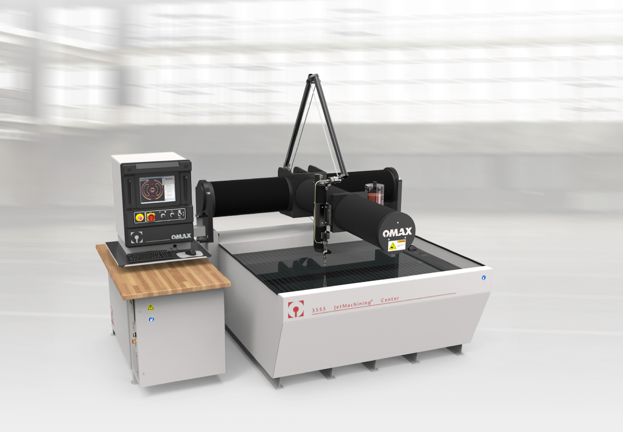

OMAX 5555
Precision Jetmachining Center
OMAX 5555 Abrasive Waterjet
