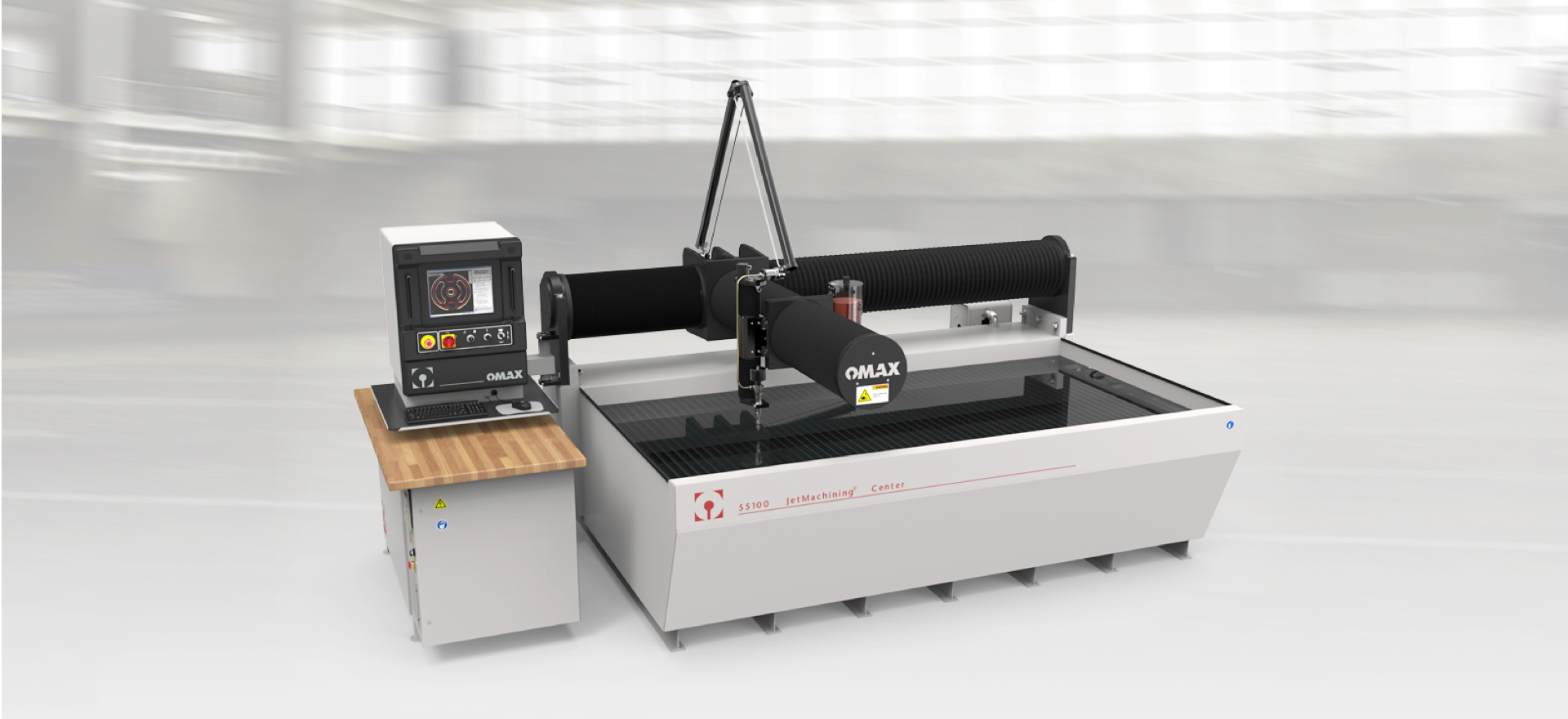

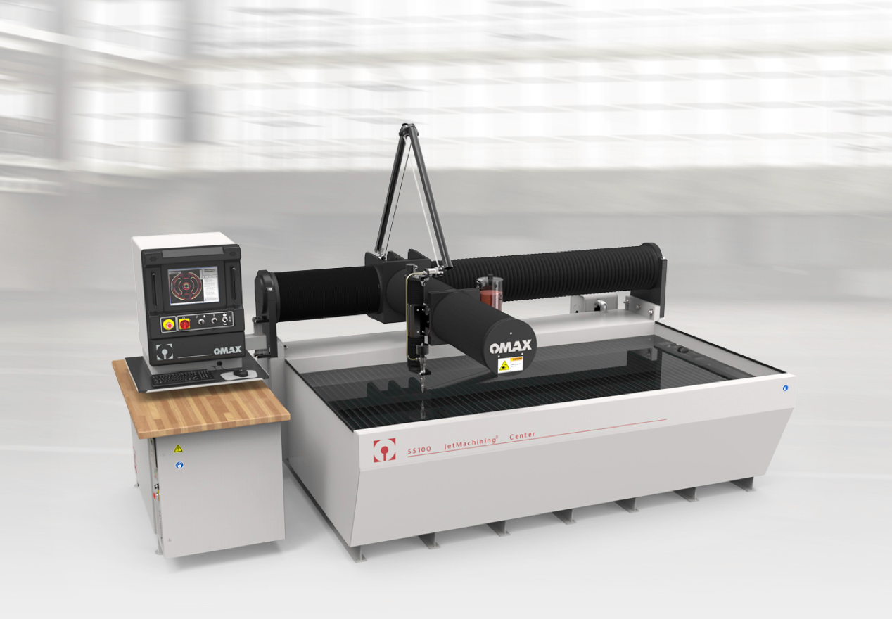

Dimensions & specs
Machine Dimensions/Envelope
Footprint (with pump & controller) 15′ 1″ x 8′ 9″ (4.60 m x 2.44 m)
Height (with Scissor plumbing) 10′ (3.05 m)
Operating Weight 21,147 lb (9,592 kg)
Weight (tank empty) 7,960 lb (3,611 kg)
X-Y Cutting Travel* 8′ 4″ x 4' 7″ (2.54 m x 1.39 m)
Z-Axis Travel (with Motorized Z Axis)* 8 (203 mm)
Table Size 10′ 6″ x 5' 5″ (3.20 m x 1.65 m)
Model Specs
Material Supports Slats 4 x 1/8 Galvanized Steel
NOISE LEVEL Below 80 dBA at one meter for submerged cutting
Speed 180 in/min (4,572 mm/min)
Linear Positional Accuracy* ±0.001″ (±0.025 mm)
Repeatability* ±0.001″ (±0.025 mm)
Ballbar Circularity* ±0.0025″ (±0.064 microns)
