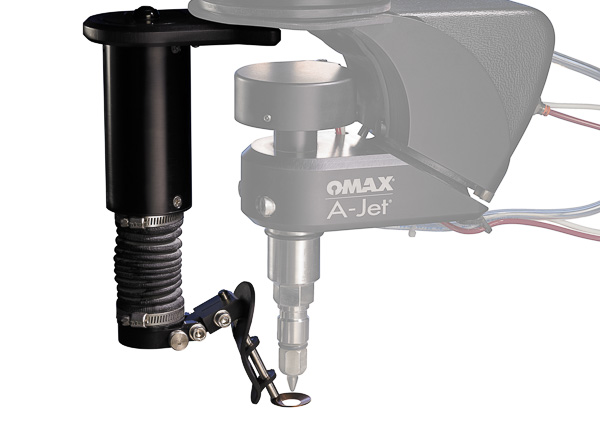

The Collision Sensing Terrain Follower is an essential tool for working with uneven surfaces. The innovative design allows you to set the machine standoff once at the start and then the Collision Sensing Terrain Follower constantly and continuously compensates for material height changes to maintain precise standoff. In addition to maintaining precise standoff.
Available on these machines:
GlobalMAX 1508, GlobalMAX 1530, GlobalMAX 2040, MAXIEM 1515X, MAXIEM 1530X, MAXIEM 2030X, MAXIEM 2040X, MAXIEM 2060X, MAXIEM 2080X, MAXIEM 3060X, OMAX 2626, OMAX 2652, OMAX 5555, OMAX 60120, OMAX 55100, OMAX 80X Series, OMAX 120X Series, OMAX 160X, OptiMAX 60X, OptiMAX 80X Series
Features
Simple setup and operation
Automatically maintains the correct nozzle standoff throughout the cutting process
Adjusts automatically to uneven surfaces; reduces need for additional programming
Constantly senses necessary height adjustments when activated, unlike other contour following products on the market
Reduces potential equipment damage from nozzle collisions
No special programming required
No requirement to map the elevation of your material—simply move the nozzle to where you want to begin cutting and push start
Electrical connections armored for durability

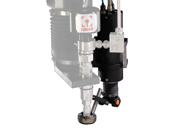

Drill
Solely customized for OMAX machining, the robust Drill permits repeatable piercing of laminates and composites prior to abrasive waterjet cutting and accurately pierces small diameter holes in thick material. With IntelliMAX innovation, no separate programming is required.
Download OMAX/MAXIEM/GlobalMAX Drill spec sheet (PDF)
Features
Successfully pre-drill brittle and sensitive materials
Corrosion-resistant cylinder wall will not rust in moist air
5,000 RPM air motor provides maximum power
Drill equipped with a collet holder and collet to hold a 1/16″ (1.5 mm) drill bit
Fully adjustable pneumatic feed rate and depth of feed up to 3″ (76 mm) of travel and 112 lbs (12.65 Nm) of thrust with 85 psi (5.8 bar) air

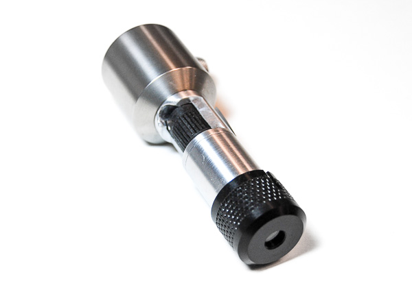

Laser Feature Finder
The Laser Feature Finder helps to perform simple dry runs with this laser attached to the nozzle before you cut parts on valuable stock. Get a rough visual reference of where your jet stream will begin cutting by locating material features without special software.
Features
Includes a polarized lens to adjust the diameter of the laser dot to focus on any size material feature
With its simple design, the accessory operates on three A76 batteries, eliminating wiring or cabling
Easy to use
Assists in finding tiny details on your material stock
Promotes the ability to get the best yield out of materials

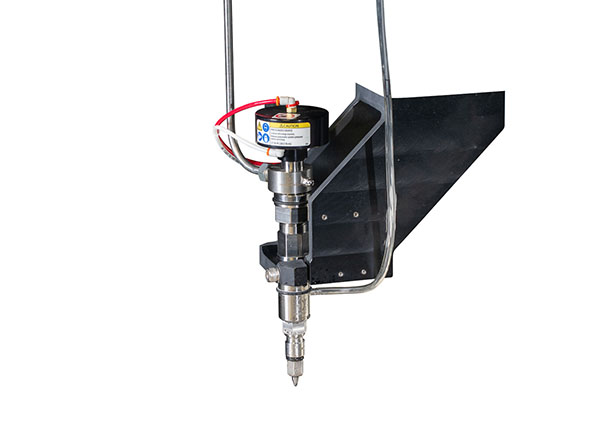

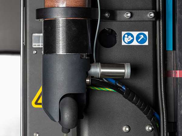

Terrain Follower
The Terrain Follower attaches directly to the A-Jet and VersaJet. Changes in a material's height are detected and the nozzle automatically makes the required height adjustments, maintaining the necessary nozzle standoff to avoid collision with warped surfaces and protecting the nozzle and related hardware from damage.
MAXIEM 1515X, MAXIEM 1530X, MAXIEM 2030X, MAXIEM 2040X, MAXIEM 2060X, MAXIEM 2080X, MAXIEM 3060X, OMAX 2652, OMAX 5555, OMAX 60120, OMAX 55100, OMAX 80X, OMAX 120X Series, OMAX 160X, OptiMAX 60X, OptiMAX 80X Series
Features
High resolution magnetic encoder senses change in material height
All electrical cabling is shielded from the abrasive waterjet environment
Designed specifically to operate in an abrasive waterjet environment
Completely retrofittable to all existing A-Jet accessories

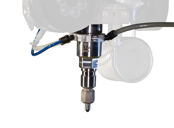

Vacuum Assist
The OMAX Vacuum Assist is ideal for piercing brittle materials. The OMAX Vacuum Assist eliminates delay between water and garnet feed, allowing for consistent automatic piercing of composites, laminates, and other materials.
MAXIEM 1515X, MAXIEM 1530X, MAXIEM 2030X, MAXIEM 2040X, MAXIEM 2060X, MAXIEM 2080X, MAXIEM 3060X, OMAX 2626, OMAX 2652, OMAX 5555, OMAX 60120, OMAX 55100, OMAX 80X, OMAX 120X Series, OMAX 160X, OMAX MicroMAX
Features
Available in a wide range of nozzle orifice sizes, from 0.007″ to 0.016″, with mixing tubes from 0.015″ to 0.048″
Low-pressure stationary piercing can help improve the circularity and edge quality of small holes
Precise on/off cycles to prevent excess garnet usage
Automatic dynamic pressure adjustments
Visible pressure gauge to verify correct pressure settings
