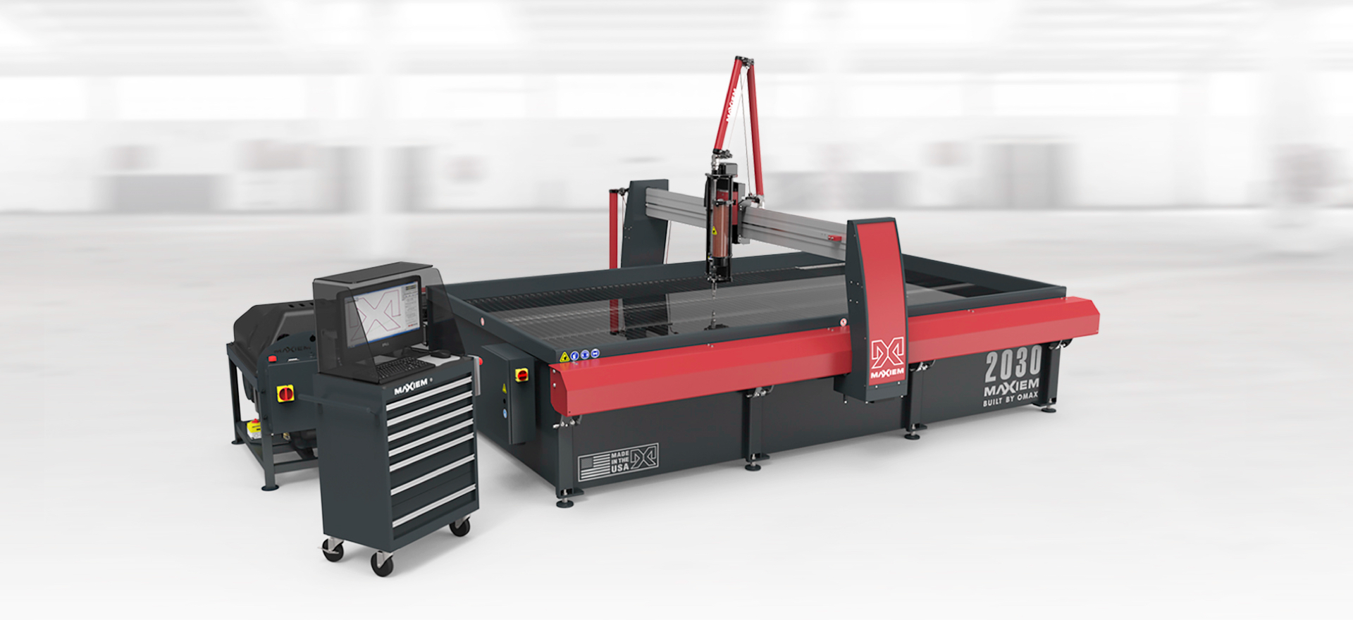

The MAXIEM 2030 handles large-scale precision machining for large or multiple parts.
  • Cutting envelope of 10' 0" x 6' 7" (3.04 m x 2.00 m)
Expand all
  • Backed by our exclusive IntelliMAX Standard Software
  • 1 year of free training
  • 1-year / 2000-hour limited warranty
DIMENSIONS & SPECS
Footprint (with pump & controller)18' x 13' 2" (5.49 m x 4.01 m)
Height (with scissor plumbing)8' 10" (2.69 m)
Operating Weight23,432 lb (10,629 kg)
Weight (tank empty)7,500 lb (3,402 kg)
X-Y Cutting Travel*10' 0" x 6' 7" (3.04 m x 2.00 m)
Z-Axis Travel (with Motorized Z Axis)*12" (304 mm)
Table Size12' 2" x 7' (3.71 m x 2.13 m)
Material Supports Slats4" x 14Ga Galvanized Steel(102 mm x 2 mm)
Maximum Supported Material Load300 lbs/sq ft (1,465 kg/sq meter)
Speed500 in/min (12,700 mm/min)
