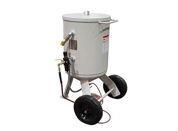

Continuous Feed Hopper CFH600
The innovative Continuous Feed Hopper improves your production times by automatic garnet delivery to the abrasive waterjet nozzle. Utilizing pneumatic pressure to transport garnet from the large capacity 600lb (272 kg) hopper pot to the cutting head hopper, the Continuous Feed Hopper helps to eliminate unplanned downtime with the ability to fill the hopper while in use.
The Continuous Feed Hopper is designed to maximize production while simplifying operations. Quality engineering has resulted in a system that is easy to use and maintain.
Download spec sheet
Contact Sales
Hopper 3
Features
•    Designed for sustainability with recyclable plastic hopper and modular steel frame
•    A removable screen provides pre-filtration that reduces downtime due to abrasive contamination
•    The large 600 lb (272 kg) hopper pot size provides hours of uninterrupted cutting
•    The open design allows for improved maintenance and troubleshooting accessibility
•    A low-level indicator light provides instant visual notification to facilitate refilling of the hopper pot
•    The integrated lid and screen allows users to fill the hopper pot while in use

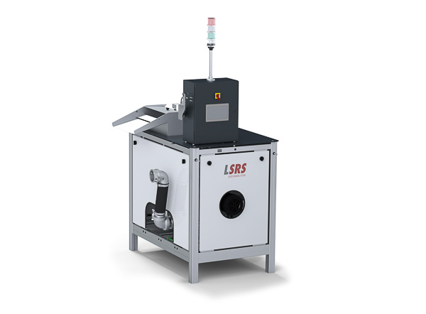

Large Solid Removal System
The PLC-controlled Large Solids Removal System (LSRS) provides precise control over evacuation rate, zone selection, and duration for efficient removal of spent abrasive from a large-bed waterjet catcher tank. The LSRS gives the user operational flexibility by allowing placement of the LSRS up to 100 feet (over 30 meters) away from the JetMachining Center.
Available on these machines:
OMAX 120X Series, OMAX 160X
Download spec sheet
Contact Sales
Large solid removal system for OMAX waterjets
Features
  • Standard Hopper can collect 2,200 lb (1,000 kg) of abrasive in industry standard bag size
  • Skid & Hopper Unit can be located remotely, up to 100 ft (30.5 m) for optimum facility placement
  • 1.5 HP diaphragm pumps provides strong suction power
  • Abrasive removal rates up to 30 lb/min (13.6 kg/min)
  • cUL-US compliant

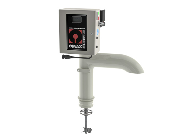

The Variable Speed Solids Removal System (VS-SRS) gives the operator the ability to program flow rate and direction. The controller's programmability provides greater garnet removal than comparable fixed speed units. An optimized fluid return trough increases settling time and minimizes abrasive volume returning to the tank.
MAXIEM 1515X, MAXIEM 1530X, MAXIEM 2030X, MAXIEM 2040X, MAXIEM 2060X, MAXIEM 2080X, MAXIEM 3060X, OMAX 2626, OMAX 2652, OMAX 5555, OMAX 55100, OMAX 120X Series, OMAX 160X, OMAX MicroMAX, OptiMAX 60X, OptiMAX 80X Series
Download spec sheet
Contact Sales
Features
  • Garnet removal rate as high as 5.6 lbs/min
  • Productively removes both large and fine particles
  • 3/4-yard hopper that includes liner for ease of removing garnet from hopper
  • Optimized fluid return trough minimizes abrasive volume returning to the tank
  • UL, CE and CSA compliant

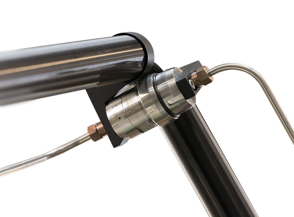

Scissor-Style Plumbing
OMAX Scissor-Style Plumbing replaces the standard whip on the MAXIEM line and OMAX 2626. Scissor-Style Plumping increases flow between the pump and cutting head with a larger interior diameter 3/8 in (9.5 mm) diameter rather than the 1/4 (6.3 mm) in interior diameter of the whip.)
OMAX 2626
Contact Sales
Swivel plumbing for OMAX waterjets
Features
  • Only requires 10-foot ceiling height
  • Increased water flow at the nozzle
  • The rigid plumping is easier to maintain
  • Swivels allow for compact machine tool operation
  • Required for the A-Jet and Dual Pump configurations

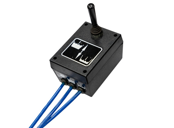

Water level control for OMAX waterjets
Water Level Control
The OMAX Rapid Water Level Control is an easy-to-use, in tank pneumatic system that enables you to quickly raise and lower the water level of your catcher tank for underwater cutting. System control is conveniently located near the controller side of the waterjet for easy access.
Contact Sales
Features
  • Reduced garnet and water splash
  • Lower noise level to approximately 76 db. when cutting under water
  • Minimizes frosting on finished parts
  • Control placed on controller for easy use
  • Helps maintain constant water level in the tank

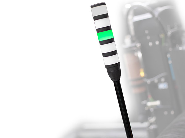

Machine Status Indicator
Decrease operator observation and increase productivity with the machine status indicator lights for OptiMAX. Utilizing industry wide known-colored lights, operators can safely monitor the abrasive waterjet from a distance while also operating other equipment or completing other tasks while watching 4 active lights on the stack.
Contact Sales
Machine Stack Indicator
Features
  • White Light: waterjet is idle and ready to operate with no faults
  • Green = normal operation, indicating a waterjet action is taking place, such as performing a cut, move, or test, and no faults or abnormal conditions are present
  • Amber = an abnormal condition, but the waterjet can continue performing cutting and moving operations
  • Red = a fault condition, and the waterjet will be unable to perform any cutting operations
