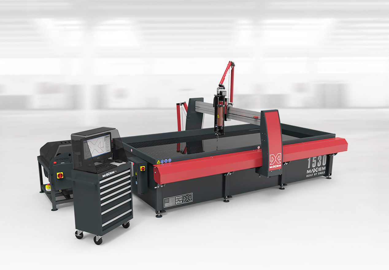

The World’s Most Popular Waterjet. A shop favorite for its balance of size and speed—perfect for custom jobs and high-mix production.
  • Cutting envelope of 10' 0" x 5' 2" (3.04 m x 1.57 m)
Expand all
  • IntelliVISOR Mobile puts machine monitoring in your hand allowing you to review status, get notification and remotely pause operations. Available on IOS and Android.
  • 1 year of free training
  • 1-year / 2000-hour limited warranty
DIMENSIONS & SPECS
Footprint (with pump & controller)18' 5" x 13' 7" (5.61 m x 4.14 m)
Height (with whip plumbing)10' 6" (3.20 m)
Operating Weight19,990 lb (9,067 kg)
Weight (tank empty)7,000 lb (3,175 kg)
X-Y Cutting Travel*10' 0" x 5' 2" (3.04 m x 1.57 m)
Z-Axis Travel (with Motorized Z Axis)*12" (304 mm)
Table Size12' 2" x 5' 8" (3.71 m x 1.73 m)
Material Supports Slats4" x 14Ga Galvanized Steel (102 mm x 2 mm)
Maximum Supported Material Load300 lbs/sq ft (1,465 kg/sq meter)
Speed500 in/min (12.70 m/min)
