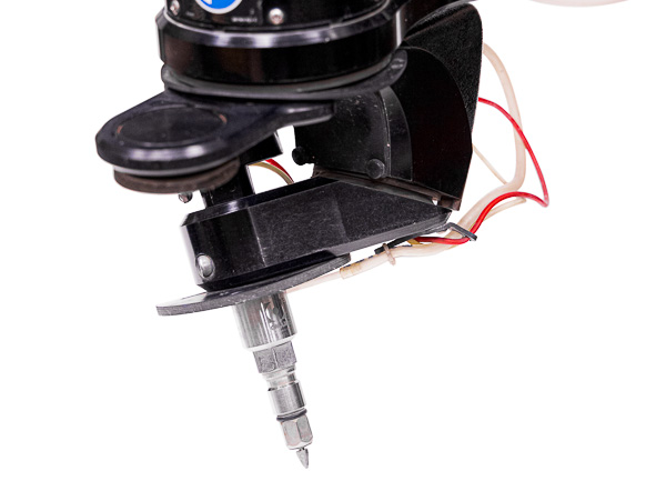

A-Jet
The A-Jet is a completely software-controlled multi-axis cutting head that greatly expands the versatility of the OMAX JetMachining Center. With a cutting range from 0° to 60°, the A-Jet can easily cut beveled edges, angled sides, countersinks as well as complex 3D shapes. With its inherent high level of positioning accuracy, the A-Jet can cut parts that require no secondary finishing, significantly reducing part production time.
Available on these machines:
MAXIEM 1515, MAXIEM 1530, MAXIEM 2030, MAXIEM 2040, MAXIEM 2060, MAXIEM 2080, MAXIEM 3060, OMAX 2652, OMAX 5555, OMAX 55100, OMAX 120X, OMAX 160X
Contact OMAX Sales
Features
- Fully automatic taper compensation to minimize taper on finished parts
- Three modes of taper compensation
- Supplied with a MAXJET 5i Nozzle, which includes an OMAX High Angle Fusible Mixing Tube
- Designed for high flow/high power abrasive waterjet applications with multiple pumps by using large diameter tubing with minimal pressure loss
- Features a fixed focal point design, where the XYZ axes do not need to move as the head tilts

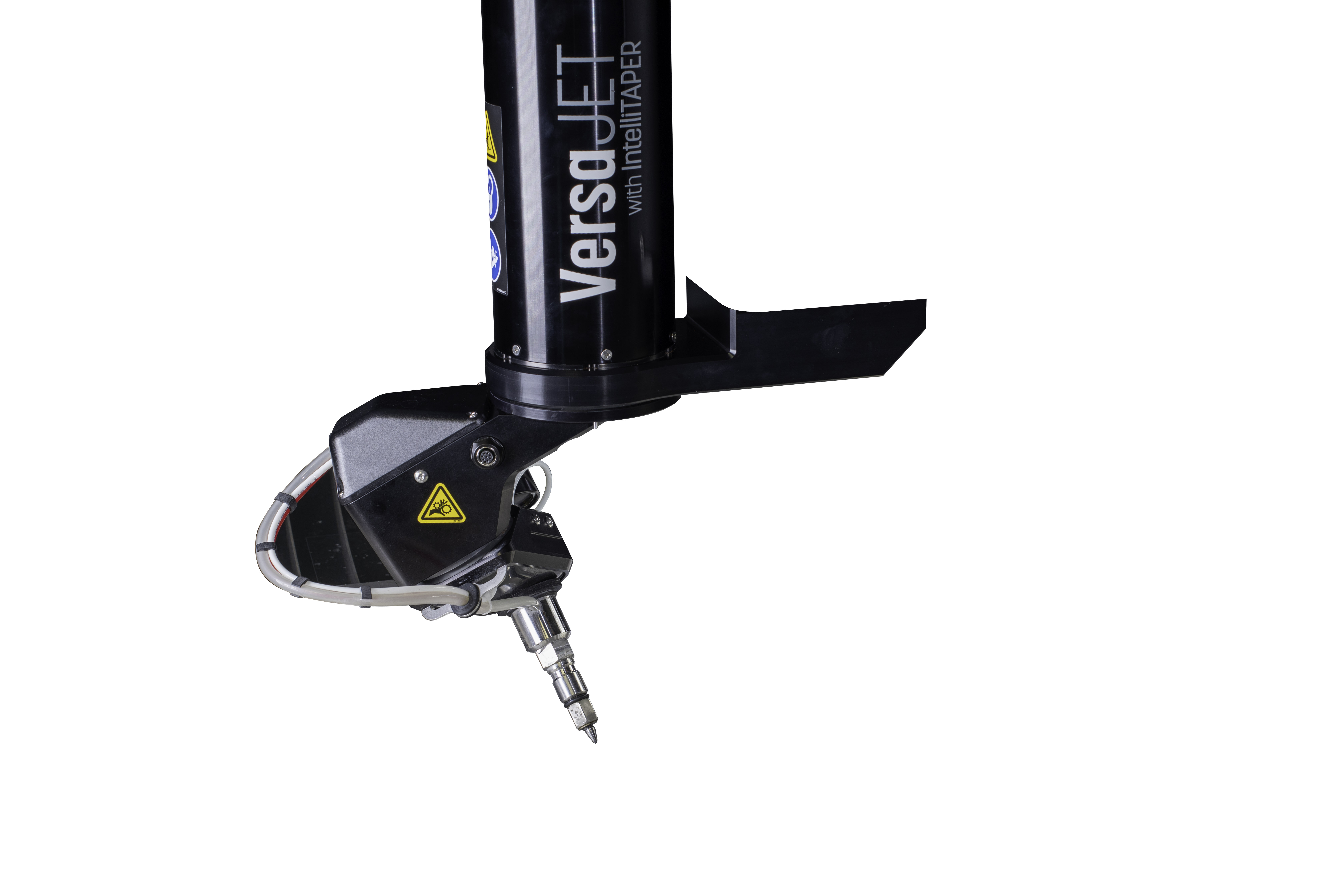

VersaJET
The VersaJET is a completely software-controlled 5 Axis cutting head that greatly expand the versatility of your abrasive waterjet. VersaJET has a cutting range of 0 to 60 degrees for cutting beveled edges, angled sides, countersinks, and complex 3D shapes. The cutting head virtually eliminates taper on finished parts with automatic taper compensation. With its inherent high level of positioning accuracy, the VersaJET can cut parts that don’t require secondary finishing, significantly reducing part production time.
OptiMAX 60X, OptiMAX 80X
Features
- Completely controlled with OMAX IntelliMAX Software
- Fixed focal point design, where the XYZ axes do not need to move as the head tilts
