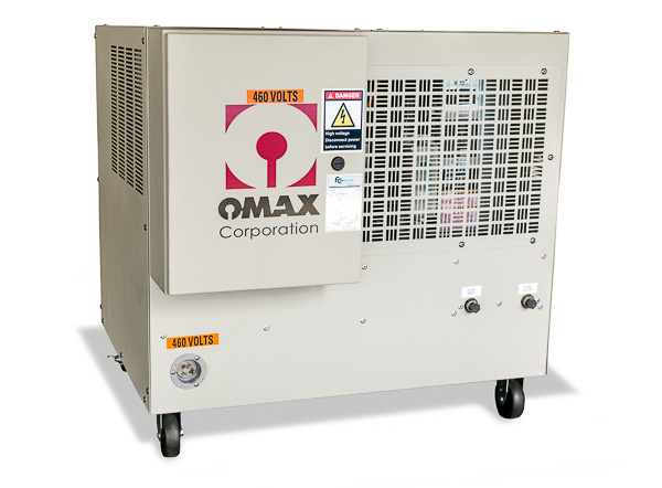

Chiller System
The air-cooled OMAX Chiller optimally supplies inlet water at a consistent temperature, which extends pump seal life for longer, more sustainable production. Using the 5 Ton Chiller or larger also allows for seamless interaction with the OMAX Water Recycling System to significantly reduce overall water consumption.
Available on these machines:
GlobalMAX 1508, GlobalMAX 1530, GlobalMAX 2040, MAXIEM 1515, MAXIEM 1530, MAXIEM 2030, MAXIEM 2040, MAXIEM 2060, MAXIEM 2080, MAXIEM 3060, OMAX 2626, OMAX 2652, OMAX 5555, OMAX 55100, OMAX 120X, OMAX 160X, OMAX MicroMAX, OptiMAX 60X, OptiMAX 80X
Contact OMAX Sales
Features
- Reduces pump rebuilds and machine downtime
- Ranco microprocessor temperature controller with LCD display
- NEMA 12/4 electrical enclosure, fully gasketed with lockable disconnect
- 1/2” NPT inlet and outlet piping connectors
- Environmentally friendly R407c refrigerant

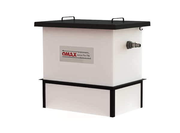

Laminar Filter
The Laminar Filter cleans overflow required for recycling through a closed loop system or for sanitary disposal. The accessory contains modular trays of angled laminar plates to capture smaller, lightweight particles during the natural settling process. The Laminar Filter is effectively designed for routine sediment cleaning.
Contact OMAX Sales
Features
- Laminar water flow efficiently removes finer particles from water
- Easy to clean
- Offers a means to comply with regional waste disposal regulations
- No expensive filters or bags to replace
- Submersible sediment pump with ground fault circuit interrupter moves sediment laden water to a Dump Hopper or Catcher Tank

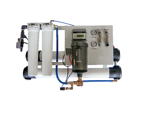

Reverse Osmosis System
In some areas, total dissolved solids can be sustained at or below 250 ppm, eliminating pre-treatment measures for effective waterjet operation. However, in areas where the total dissolved solids (TDS) rise more than 250 ppm, an OMAX Reverse Osmosis System can be just the assurance you need to provide clean, pure water to your equipment.
Contact OMAX Sales
Features
- Can remove up to 90% of total dissolved solids in water
- Two types of pre-treatment filters: 5-micron and carbon black
- Includes a digital total dissolved solids meter for quick visual review
- Time clock-initiated water softener system capable of a 10-gpm flow rate with 45,000 grains removed
- Two 4” x 40” membranes capable of handling over 4,000 gallons per day at 77 psi

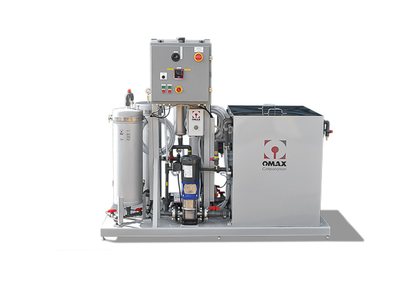

The OMAX Water Recycling System is designed to capture the workable overflow water for recycling to the proper specifications, then returning the water back to the high-pressure pump. A filtration system traps suspended particles and ensures high quality water feeds to the high pressure pump. An ozone generator is used to reduce bacteria growth.
Contact OMAX Sales
Features
- Resin for TDS/dissolved solids filtering
- Ozone generator for bacteria control
- Separate chiller for heat dissipation
- One-micron absolute final filter
- Filter, deionization resin, and low water alarms
