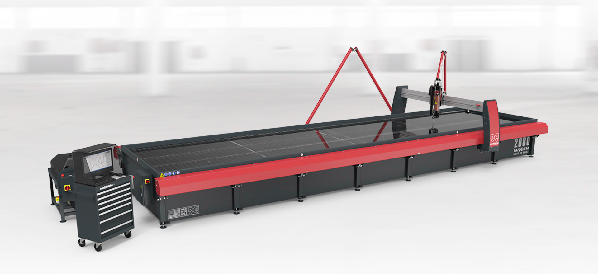

The MAXIEM 2080 is versatile for nearly any material cutting need from prototyping to production.
  • Cutting envelope of 27' 10" x 7' (8.48 m x 2.00 m)
Expand all
  • Backed by our exclusive IntelliMAX Standard Software
  • 1 year of free training
  • 1-year / 2000-hour limited warranty
DIMENSIONS & SPECS
Footprint (with pump & controller)35' 1" x 12' 11" (10.69 m x 3.94 m)
Height (with scissor plumbing)10' 4" (3.15 m)
Operating Weight50,123 lb (22,735 kg)
Weight (tank empty)12,800 lb (5,806 kg)
X-Y Cutting Travel*27' 2" x 6' 7" (8.28 m x 2.00 m)
Z-Axis Travel (with Motorized Z Axis)*12" (304 mm)
Table Size27' 10" x 7' (8.48 m x 2.13 m)
Material Supports Slats4" x 14Ga Galvanized Steel(102 mm x 2 mm)
Maximum Supported Material Load300 lbs/sq ft (1,465 kg/sq meter)
Speed500 in/min (12.70 m/min)
