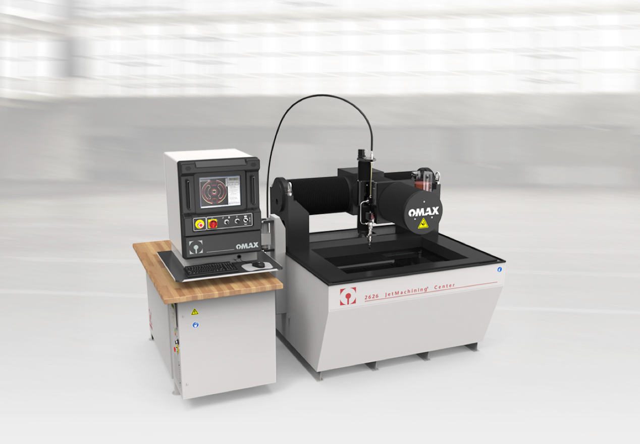

The small size and an efficient work envelope, the OMAX 2626 is a perfect fit for even the most space-challenged shops.
Cutting envelope of 2′ 2″ x 2′ 2″ (0.66 m x 0.66 m)
±0.001″ (±0.025 mm) linear position accuracy

Features
Backed by OMAX's exclusive IntelliMAX Premium Software
Pre-loaded linear bearings and precision ball screws
Standard programmable Motorized Z-Axis with a precision OMAX MAXJET 5i Nozzle boosts productivity and process efficiency
Standard Rapid Water Level Control for cleaner, safer, and quieter submerged cutting completes most work below 80 dBA
Standard whip plumbing
Designed and manufactured at the OMAX facility in Kent, Washington, USA
Does not create heat-affected zones or mechanical stresses
Machines a wide range of materials and thicknesses, from metals and composites to glass and plastics
No tool changes & minimal fixturing dramatically reduce setup
Unlimited free training for the life of your machine
Unlimited software upgrades for the life of the machine
2-year / 4000-hour limited warranty
3 days of onsite training upon installation

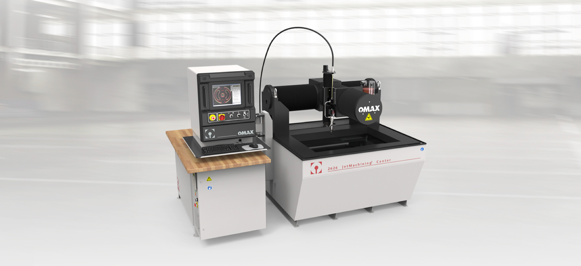

Dimensions & specs
Machine Dimensions/Envelope
| Footprint (with pump & controller) | 9′ 9″ x 6′ 10″ (2.97 m x 2.08 m) |
| Height (with whip plumbing) | 8′ (2.44 m) |
| Operating Weight | 7,393 lb (3,353 kg) |
| Weight (tank empty) | 3,800 lb (1,742 kg) |
| X-Y Cutting Travel* | 2′ 2″ x 2' 2″ (0.66 m x 0.66 m) |
| Z-Axis Travel (with Motorized Z Axis)* | 8″ (203 mm) |
| Table Size | 3′ 10″ x 2' 7″ (1.17 m x 0.79 m) |
Model Specs
| Material Supports Slats | 4″ x 1/8″ Galvanized Steel |
| Maximum Supported Material Load | 400 lbs/sq ft (1,950 kg/sq meter) |
| Electrical Requirements | 3-Phase, 380-480 VAC ±10%, 50-60 Hz |
| NOISE LEVEL | Below 80 dBA at one meter for submerged cutting |
| Speed | 180 in/min (4.57 m/min) |
| Linear Positional Accuracy* | ±0.001″ (±0.025 mm) |
| Repeatability* | ±0.001″ (±0.025 mm) |
| Ballbar Circularity* | ±0.0025″ (±0.064 microns) |
Pump info
| EnduroMAX 100 HP | EnduroMAX 50 HP | EnduroMAX 30 HP | DynaMAX 330 | |
| Motor Power | 100 HP (75 kW) | 50 HP (37kW) | 30 HP (22 kW) | 30 HP (22 kW) |
| MAX Jet Power | 85 HP (63 kW) | 42.5 HP (31.5 kW) | 25.5 HP (18.7 kW) | 20.6 HP (15.1 kW) |
| Output Pressure | 60,000 psi | 60,000 psi | 60,000 psi | 60,000 psi |
| Orifice & Flow Rate ** | 0.022″ / 2.25 gpm (0.56 mm / 8.52 lpm) |
0.016″ / 1.20 gpm (0.41 mm / 4.54 lpm) |
0.012″ / 0.67 gpm (0.30 mm / 2.54 lpm) |
0.014″ / 1.0 gpm (0.35 mm / 3.8 lpm) |
| Footprint LxWxH | 44″ x 62″ x 44″ (1,118 mm x 1,575 mm x 1,118 mm) |
66″ x 36″ x 38.5″ (1,676 mm x 914 mm x 978 mm) |
43″ x 53″ x 40″ (1090 mm x 1350 mm x 1010 mm) |
