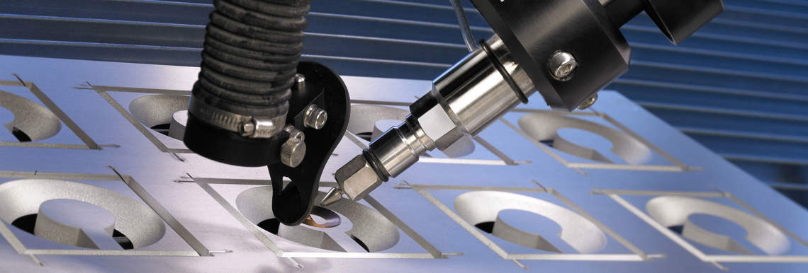

Terrain Follower
The Terrain Follower attaches directly to the A-Jet and VersaJet. Changes in a material's height are detected and the nozzle automatically makes the required height adjustments, maintaining the necessary nozzle standoff to avoid collision with warped surfaces and protecting the nozzle and related hardware from damage.
Available on these machines:
MAXIEM 1515X, MAXIEM 1530X, MAXIEM 2030X, MAXIEM 2040X, MAXIEM 2060X, MAXIEM 2080X, MAXIEM 3060X, OMAX 2652, OMAX 5555, OMAX 60120, OMAX 55100, OMAX 80X, OMAX 120X Series, OMAX 160X, OptiMAX 60X, OptiMAX 80X Series
Features
High resolution magnetic encoder senses change in material height
All electrical cabling is shielded from the abrasive waterjet environment
No special programming required
Designed specifically to operate in an abrasive waterjet environment
Completely retrofittable to all existing A-Jet accessories
