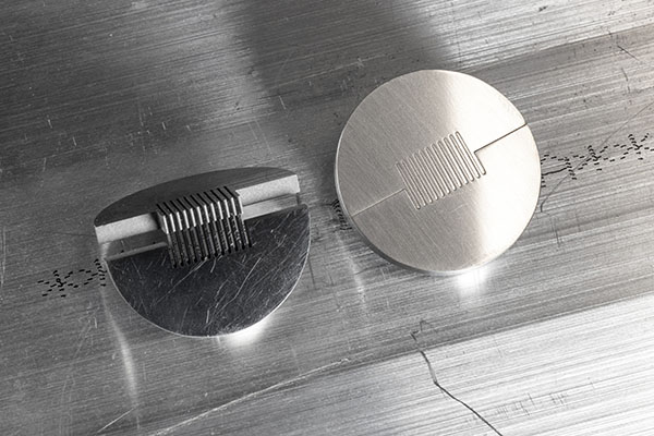

Navigating Tolerances in Real Shop Conditions
It is important to separate machine positional accuracy from finished part precision.
Positional accuracy is what the machine is mechanically capable of. Finished part precision reflects what you get off the table after factoring in material behavior, fixturing, and cutting conditions.
OMAX systems are capable of general part tolerances between ±0.0001 and ±0.005". Hitting that consistently depends on proper fixturing to keep the material stable under cutting forces.

Material Thickness and Stream Behavior
As thickness increases, the jet loses energy through the cut. This causes stream lag and widening at the bottom of the kerf.
This effect becomes more pronounced in thick materials and needs to be accounted for if you want consistent tolerances across the full thickness. The type of kerf expansion can be countered by OMAX Taper Compensation with TiltaJET for the OMAX and OptiMAX.
Traverse Speed and Edge Quality
Speed directly impacts edge quality.
Cutting too fast increases lag and creates visible striations along the lower edge. These conditions reduce dimensional accuracy and often require secondary finishing.
Tighter tolerances typically require slower, more controlled cutting speeds.

The Taper Myth
Taper is not something you have to accept.
While it is a natural result of the cutting process, modern software and multi-axis cutting heads allow you to control or eliminate it on the finished edge.

Control Taper with Multi-Axis Cutting
The TiltaJet allows you to shift taper to the scrap side.
IntelliMAX Software adjusts the nozzle angle automatically, helping maintain square edges while keeping productivity high.
