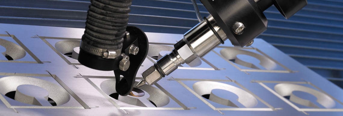

Drill
Solely customized for OMAX machining, the robust Drill permits repeatable piercing of laminates and composites prior to abrasive waterjet cutting and accurately pierces small diameter holes in thick material. With IntelliMAX innovation, no separate programming is required.

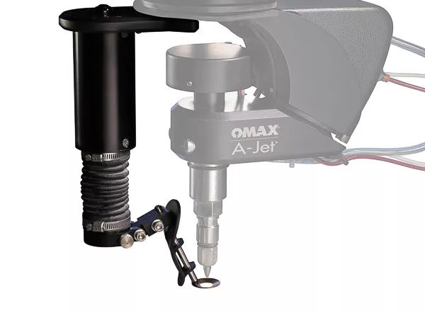

Laser Feature Finder
The Laser Feature Finder helps to perform simple dry runs with this laser attached to the nozzle before you cut parts on valuable stock. Get a rough visual reference of where your jet stream will begin cutting by locating material features without special software.

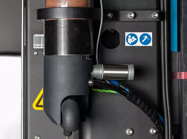

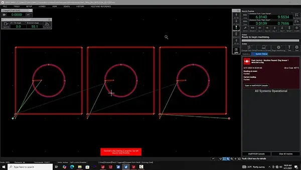

OptiMAX Vacuum Clog Sensor
The OptiMAX Vacuum Clog Sensor pairs with the IntelliMAX software to seamlessly clear a clog during a cut without requiring intervention from the waterjet operator. The Vacuum Clog Sensor will automatically detect and safely clear the clog before returning back to the location on the cutting path where the clog occurred to resume cutting.
Available on these machines:
Features
Can be retrofitted to any OptiMAX waterjet system
The sensor can be added to the Motorized Z, TiltaJET, or VersaJET cutting head
Communicates with OMAX IntelliVISOR to alert users in the event of a clog
