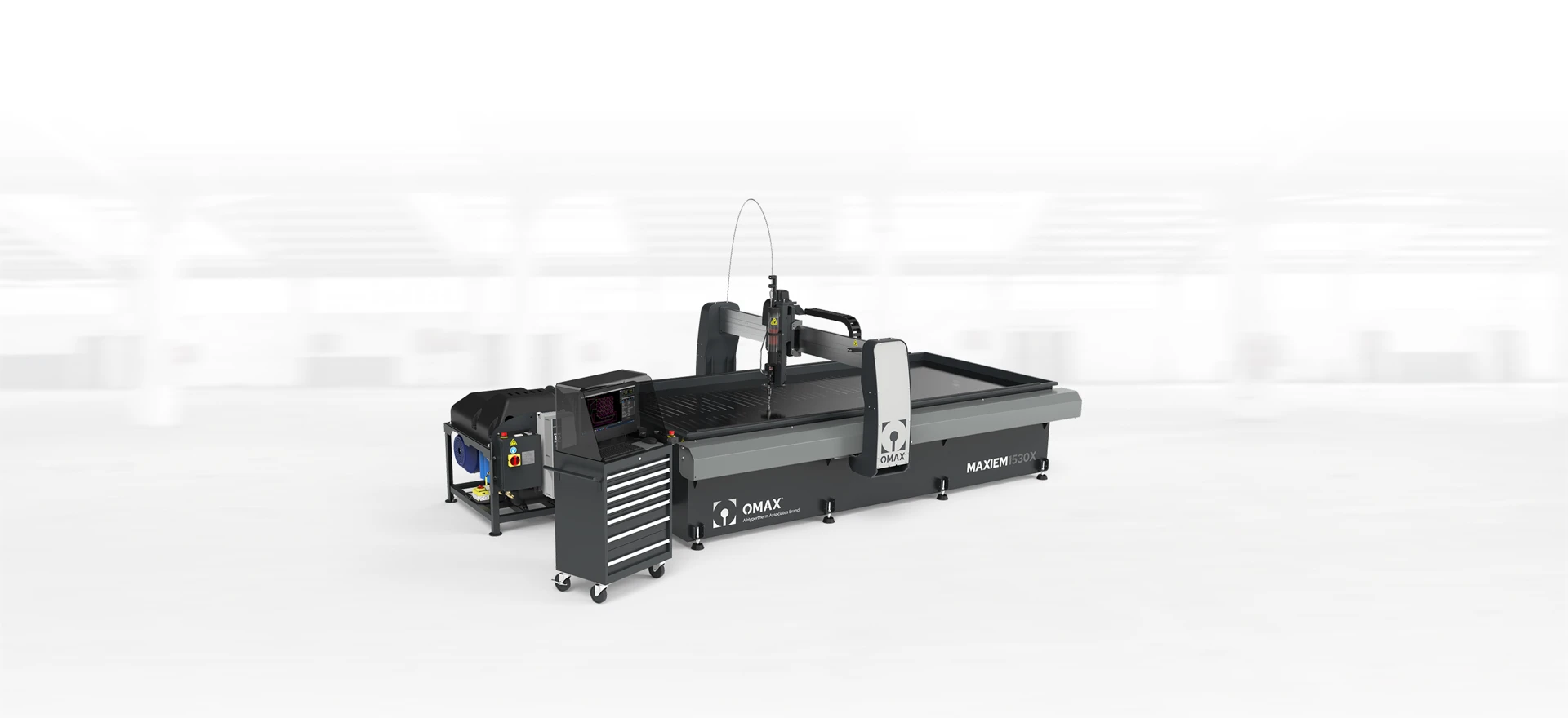

MAXIEM 1530X Jetmachining Center
The World’s Most Popular Waterjet. A shop favorite for its balance of size and speed—perfect for custom jobs and high-mix production.
Cutting envelope of 10′ 0″ x 5′ 2″ (3.04 m x 1.57 m)
±0.003″ (±0.076 mm) linear position accuracy

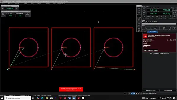

Powered by OMAX's own IntelliMAX Premium Software
Powerful all-in-one controller computer with large 23″ screen

Clog Sensor
