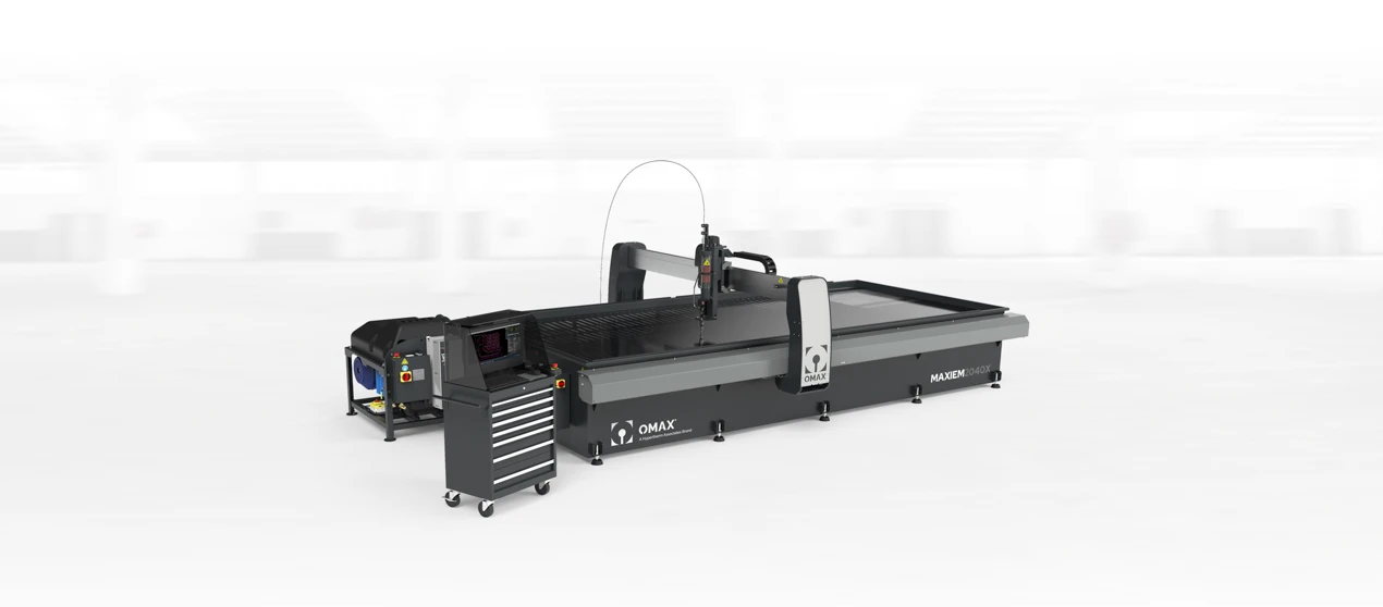

MAXIEM 2040X
Jetmachining Center
MAXIEM 2040X Abrasive Waterjet
Features
  • IntelliVISOR Mobile puts machine monitoring in your hand allowing you to review status, get notification and remotely pause operations. Available on IOS and Android.
  • 1 year of free training
  • 1 year / 2000-hour limited warranty
Dimensions & specs
Machine Dimensions/Envelope
Footprint (with pump & controller) 21′ 9″ x 12′ 11″ (6.63 m x 3.94 m)
Height (with SCISSOR plumbing) 8′ 10″ (2.69 m)
Operating Weight 28,283 lb (12,829 kg)
Weight (tank empty) 8,500 lb (3,856 kg)
X-Y Cutting Travel* 13′ 10″ x 6' 7″ (4.21 m x 2.00 m)
Z-Axis Travel (with Motorized Z Axis)* 12″ (304 mm)
Table Size 16′ 1″ x 7' (4.90 m x 2.13 m)
Model Specs
Material Supports Slats 4″ x 14 Gauge Galvanized Steel (102 mm x 2 mm)
Maximum Supported Material Load 300 lbs/sq ft (1,465 kg/sq meter)
Speed 500 in/min (12.70 m/min)
Linear Positional Accuracy* ±0.003″ (±0.076 mm)
Repeatability* ±0.001″ (±0.025 mm)

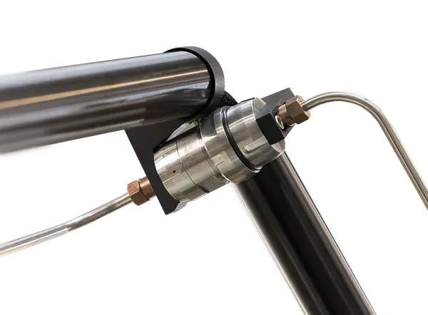

Scissor Style Plumbing
OMAX Scissor-Style Plumbing replaces the standard whip on the MAXIEM.
