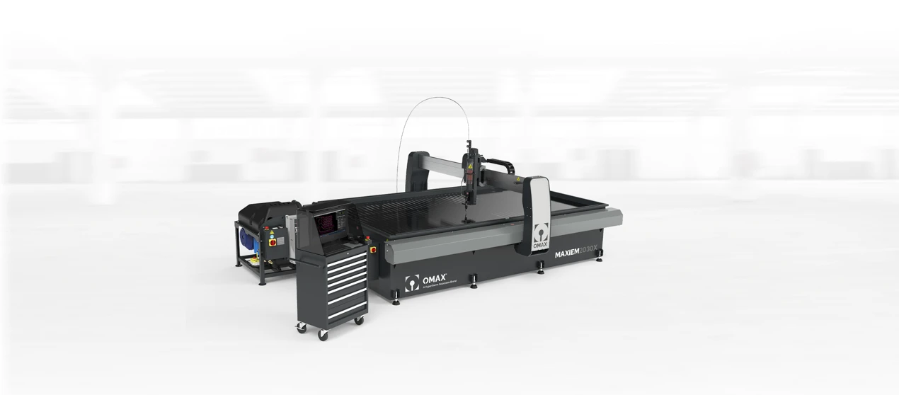

MAXIEM 2030X
Jetmachining Center
MAXIEM 2030X Abrasive Waterjet
Features
  • Powerful all-in-one controller computer with large 23″ screen
  • IntelliVISOR Mobile puts machine monitoring in your hand allowing you to review status, get notification and remotely pause operations. Available on IOS® and Android®.
  • 1 year of free training
  • 1-year / 2000-hour limited warranty
Dimensions & specs
Machine Dimensions/Envelope
Footprint (with pump & controller) 18′ 5″ x 13′ 2″ (5.49 m x 4.01 m)
Height (with scissor plumbing) 8′ 10″ (2.69 m)
Operating Weight 23,432 lb (10,629 kg)
Weight (tank empty) 7,500 lb (3,402 kg)
X-Y Cutting Travel* 10′ 0″ x 6' 7″ (3.04 m x 2.00 m)
Z-Axis Travel (with Motorized Z Axis)* 12″ (304 mm)
Table Size 12′ 2″ x 7' (3.71 m x 2.13 m)
Model Specs
Material Supports Slats 4″ x 14 Gauge Galvanized Steel (102 mm x 2 mm)
Maximum Supported Material Load 300 lbs/sq ft (1,465 kg/sq meter)
Speed 500 in/min (12,700 m/min)
Linear Positional Accuracy* ±0.003″ (±0.076 mm)
Repeatability* ±0.001″ (±0.025 mm)
