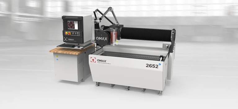

The OMAX 2652 offers a small footprint for space-challenged shops, allowing plenty of cutting envelope.
Cutting envelope of 4′ 4″ x 2′ 2″ (1.32 m x 0.66 m)
±0.001″ (±0.025 mm) linear position accuracy

Dimensions & specs
Machine Dimensions/Envelope
| Footprint (with pump & controller) | 12′ 1″ x 6′ 3″ (3.68 m x 1.91 m) |
| Height (with SCISSOR plumbing) | 8′ (2.44 m) |
| Operating Weight | 10,252 lb (4,650 kg) |
| Weight (tank empty) | 4,300 lb (1,950 kg) |
| X-Y Cutting Travel* | 4′ 4″ x 2' 2″ (1.32 m x 0.66 m) |
| Z-Axis Travel (with Motorized Z Axis)* | 8″ (203 mm) |
| Table Size | 5′ 9″ x 2' 6″ (1.75 m x 0.76 m) |
Model Specs
| Material Supports Slats | 4″ x 1/8″ Galvanized Steel |
| Maximum Supported Material Load | 400 lbs/sq ft (1,950 kg/sq meter) |
| Electrical Requirements | 3-Phase, 380-480 VAC ±10%, 50-60 Hz |
| NOISE LEVEL | Below 80 dBA at one meter for submerged cutting |
| Speed | 180 in/min (4.57 m/min) |
| Linear Positional Accuracy* | ±0.001″ (±0.025 mm) |
| Repeatability* | ±0.001″ (±0.025 mm) |
| Ballbar Circularity* | ±0.0025″ (±0.064 microns) |
