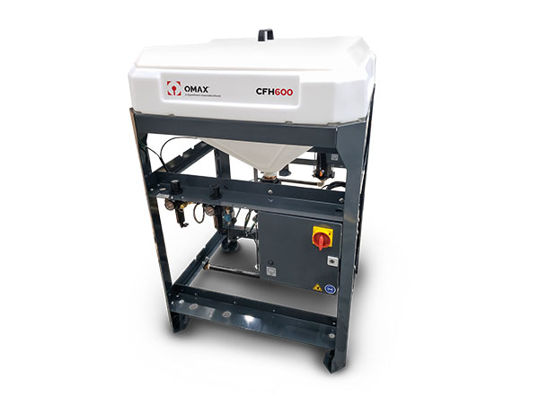

Continuous Feed Hopper CFH600
The innovative Continuous Feed Hopper improves your production times by automatic garnet delivery to the abrasive waterjet nozzle. Utilizing pneumatic pressure to transport garnet from the large capacity 600 lb (272 kg) hopper pot to the cutting head hopper, the Continuous Feed Hopper helps to eliminate unplanned downtime with the ability to fill the hopper while in use.
The Continuous Feed Hopper is designed to maximize production while simplifying operations. Quality engineering has resulted in a system that is easy to use and maintain.
Download spec sheet
Contact Sales
Hopper 3
Features
  • Designed for sustainability with recyclable plastic hopper and modular steel frame
  • A removable screen provides pre-filtration that reduces downtime due to abrasive contamination
  • The large 600 lb (272 kg) hopper pot size provides hours of uninterrupted cutting
  • The open design allows for improved maintenance and troubleshooting accessibility
  • A low-level indicator light provides instant visual notification to facilitate refilling of the hopper pot
  • The integrated lid and screen allows users to fill the hopper pot while in use

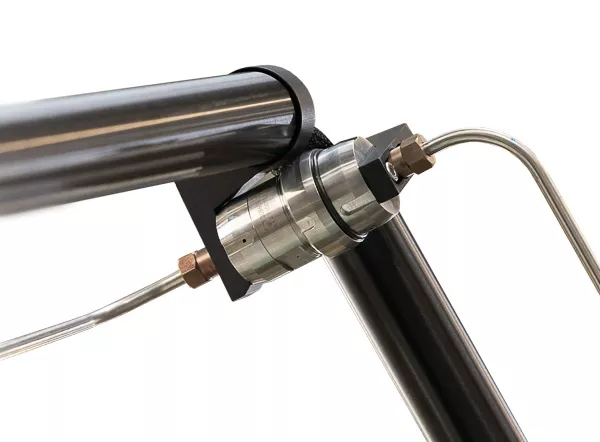

Scissor-Style Plumbing
OMAX Scissor-Style Plumbing replaces the standard whip on the MAXIEM line and OMAX 2626. Scissor-Style Plumping increases flow between the pump and cutting head with a larger interior diameter 3/8″ (9.5 mm) diameter rather than the 1/4″ (6.3 mm) in interior diameter of the whip.)
Available on these machines:
OMAX 2626
Contact Sales
Swivel plumbing for OMAX waterjets
Features
  • Only requires 10-foot ceiling height
  • Increased water flow at the nozzle
  • The rigid plumping is easier to maintain
  • Swivels allow for compact machine tool operation
  • Required for the A-Jet and Dual Pump configurations

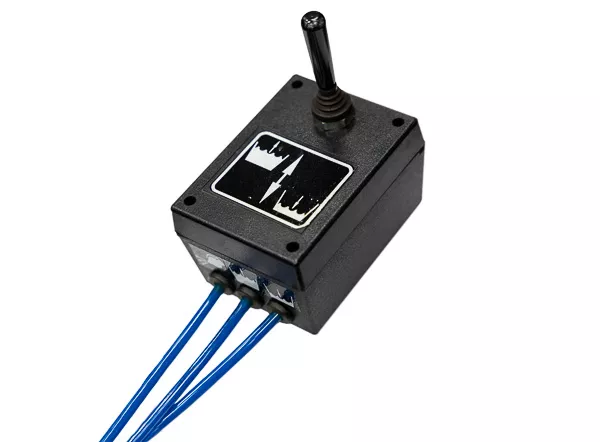

Water level control for OMAX waterjets
Water Level Control
The OMAX Rapid Water Level Control is an easy-to-use, in tank pneumatic system that enables you to quickly raise and lower the water level of your catcher tank for underwater cutting. System control is conveniently located near the controller side of the waterjet for easy access.
MAXIEM 1515X, MAXIEM 1530X, MAXIEM 2030X, MAXIEM 2040X, MAXIEM 2060X, MAXIEM 2080X, MAXIEM 3060X
Contact Sales
Features
  • Reduced garnet and water splash
  • Lower noise level to approximately 76 db. when cutting under water
  • Minimizes frosting on finished parts
  • Control placed on controller for easy use
  • Helps maintain constant water level in the tank

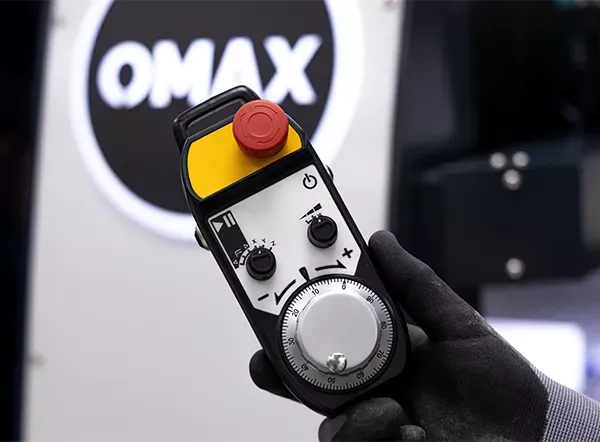

OptiMAX Bridge Pendant
The OptiMAX® Bridge Pendant allows the waterjet operator to move the Cutting Head and the Bridge along X, Z and Y Axis, dial in the cutting head to the work piece, or perform dry runs to test drawings or material fixturing.
OptiMAX 60X, OptiMAX 80X Series
Download spec sheet
Contact Sales
Features
  • Handheld pendant that is easy for operators to hold and work on the material.
  • Rotator dial to move the Cutting Head and Bridge along the X, Z and Y Axis.
  • Ability to run a dry run on path to make sure the material and the geometry are set up correctly.
  • Mounted on the bridge upright for quick grab and access to the whole cutting envelope with a 16ft long cord (5 meters).
  • Integrated with the OMAX IntelliMAX® MAKE software, with clear signals to tell the operator if the main controller or the pendant is active and in control.
