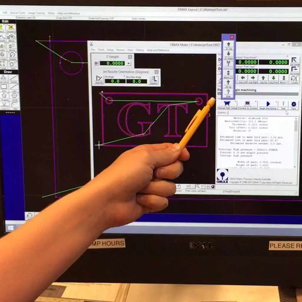

OMAX Compatible Program What file types are compatible with IntelliMAX?
The OMAX IntelliMAX Software Suite provides extensive CAD/CAM file format support, allowing manufacturers to import designs from many of the world's most widely used engineering, drafting, and industrial design platforms. IntelliMAX supports files created in applications such as SolidWorks, CATIA, AutoCAD, Autodesk Inventor, Solid Edge, Creo, and other leading CAD systems, helping streamline the transition from design to production. From 2D drawings and DXF files to complex 3D models, IntelliMAX reduces the need for file conversion while accelerating programming, toolpath generation, and abrasive waterjet machining operations. This broad compatibility allows manufacturers to leverage existing engineering workflows while improving efficiency across the entire manufacturing process.
