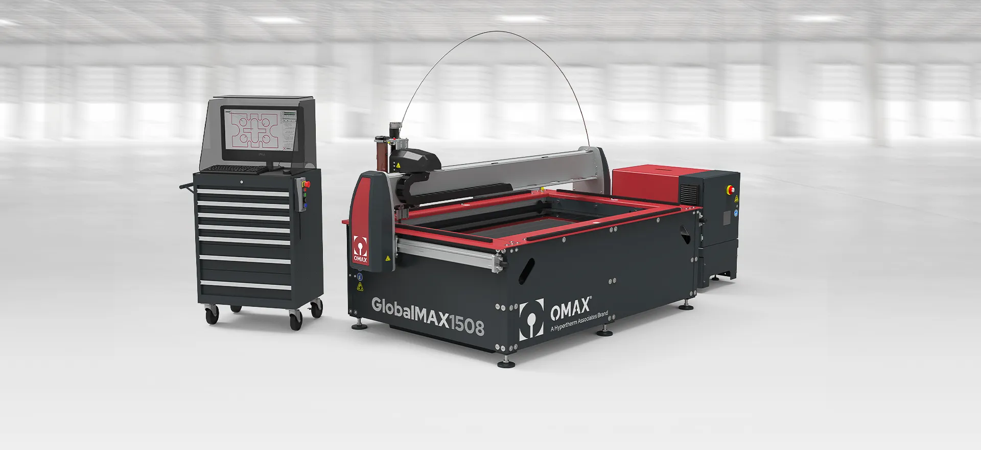

GlobalMAX 1508 Jetmachining Center
The GlobalMAX 1508 is a compact, value-focused yet powerful abrasive waterjet.
Cutting envelope of 2′ 7″ x 5′ 0″ (0.78 m x 1.52 m)
±0.003″ (±0.076 mm) linear position accuracy

Dimensions & specs
Machine Dimensions/Envelope
| Footprint (with pump) | 5′ 3″ x 11′ 8″ (1.60 m x 3.54 m) |
| Height (with WHIP plumbing) | 7′ 2″ (2.18 m) |
| Operating Weight (WITH WATER IN TANK) | 5,400 lb (2,449 kg) |
| Weight (tank empty) | 3,280 lb (1,488 kg) |
| X-Y Cutting Travel* | 2′ 7″ x 5' (0.78 m x 1.52 m) |
| Z-Axis Travel | 5″ (127 mm) |
| Table Size | 2′ 10″ x 5' 5″ (0.86 m x 1.64 m) |
Model Specs
| Maximum Supported Material Load | 100 lbs/sq ft (488 kg/sq meter) |
| Electrical Requirements | Varies depending on configuration (See pump specs) |
| Noise Level | Below 80 dBA at one meter for submerged cutting |
| Speed | 500 in/min (12.7 m/min) |
| Linear Positional Accuracy* | ±0.003″ (±0.076 mm) |
| Repeatability* | ±0.001″ (±0.025 mm) |
| Ballbar Circularity* | ±0.007″ (±0.0178 mm) |
