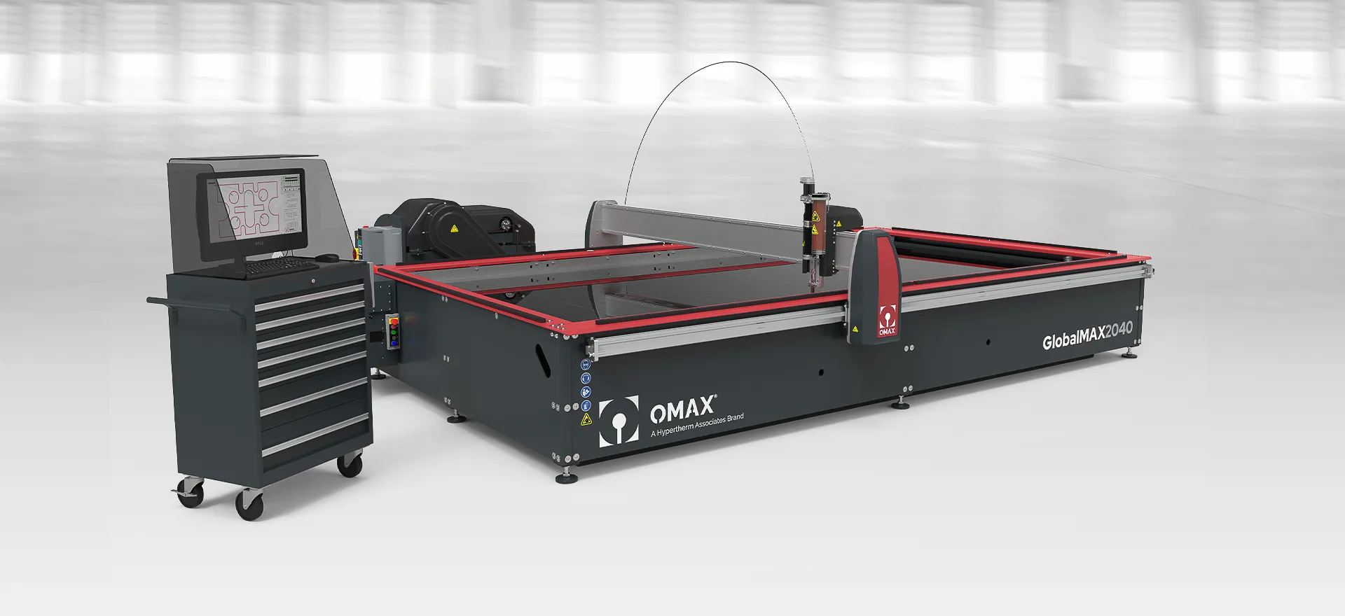

GlobalMAX 2040 JETMACHINING CENTER
The GlobalMAX 2040 abrasive waterjet is a value-focused abrasive waterjet that can cut almost any material and a wide variety of thicknesses.
Cutting envelope of 13′ 3″ x 6′ 8″ (4.03 m x 2.03 m)
±0.003″ (±0.076 mm) linear position accuracy
