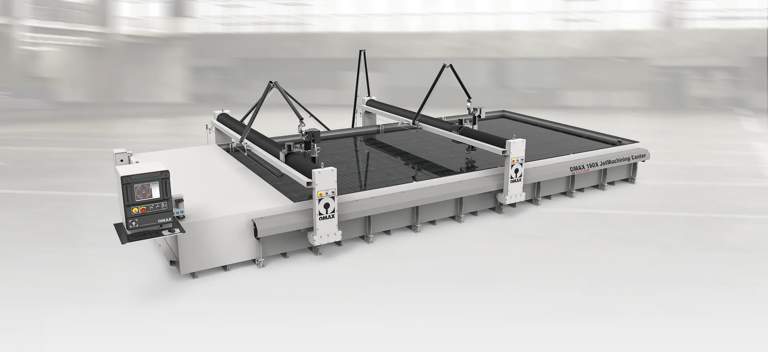

OMAX 160X
Precision Jetmachining Center
OMAX 160X Abrasive Waterjet
Features
Standard Features
  • Advanced high-precision IntelliTRAX linear drive technology designed exclusively for the abrasive waterjet environment
  • Standard 600 lb Bulk Abrasive Delivery System transports garnet from the assembly's large hopper into the Zero Downtime Hopper located on the Z-Axis
OMAX Benefits
Service & Training
Dimensions & specs
Machine Dimensions/Envelope
Footprint (with pump) 37′ 1″ x 25′ 6″ to 56′ 0″ x 25′ 6″  (11.30 m x 7.77 m to 17.06 m x 7.77 m)
Height (with whip plumbing) 11′ 0″ (3.35 m)
Operating Weight 83,000 lbs to 199,000 lbs (37,648 kg to 90,265 kg)
Weight (tank empty) 47,500 lb (21,546 kg)
X-Y Cutting Travel* 20′ 0″ x 13' 4″ to 46′ 8″ x 13' 4″ (6.09 m x 4.06 m to 14.22 m x 4.06 m)
Z-Axis Travel (with Motorized Z Axis)* 8 (203 mm)
Table Size 21′ 7″ x 14' 9″ to 48′ 6″ x 14' 9″ (6.57 m x 4.49 m to 14.78 m x 4.49 m)
