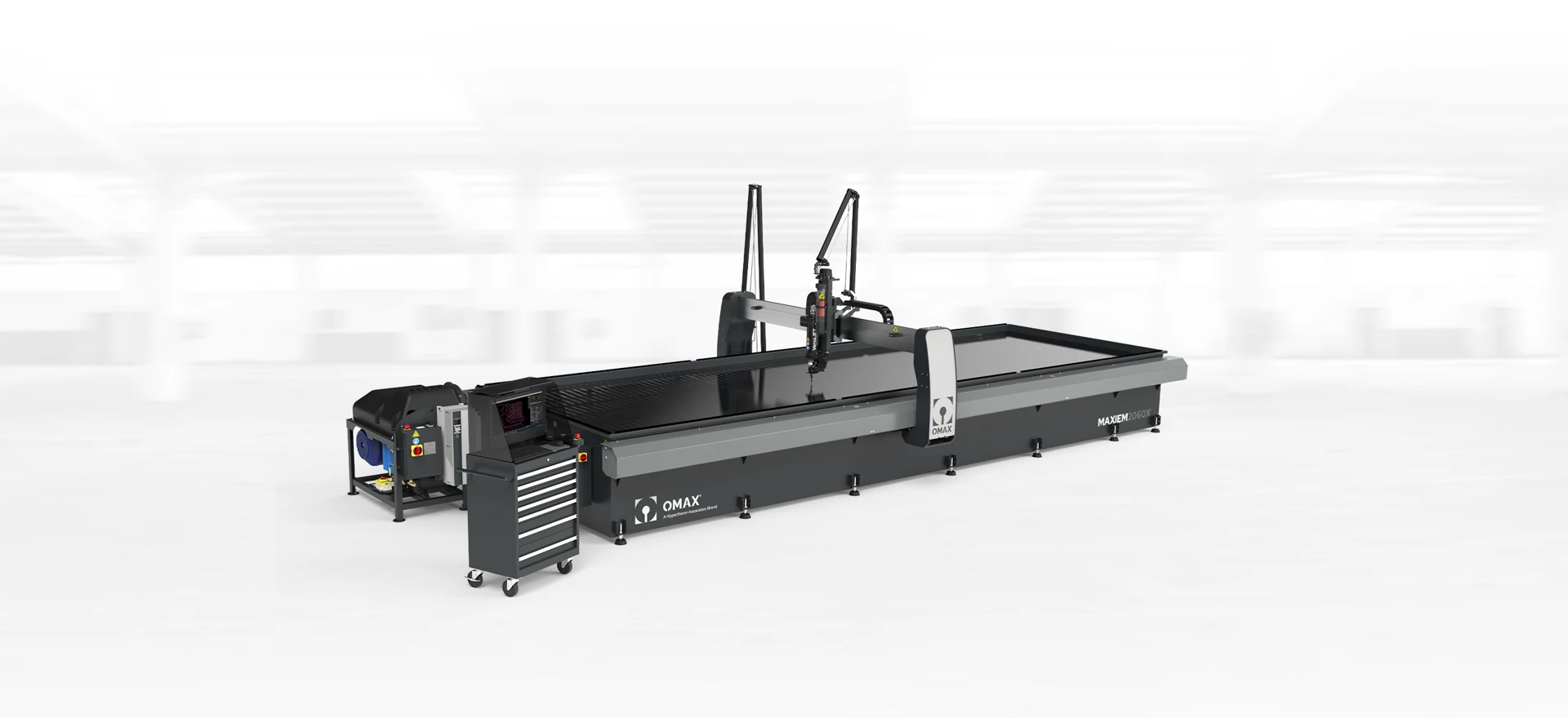

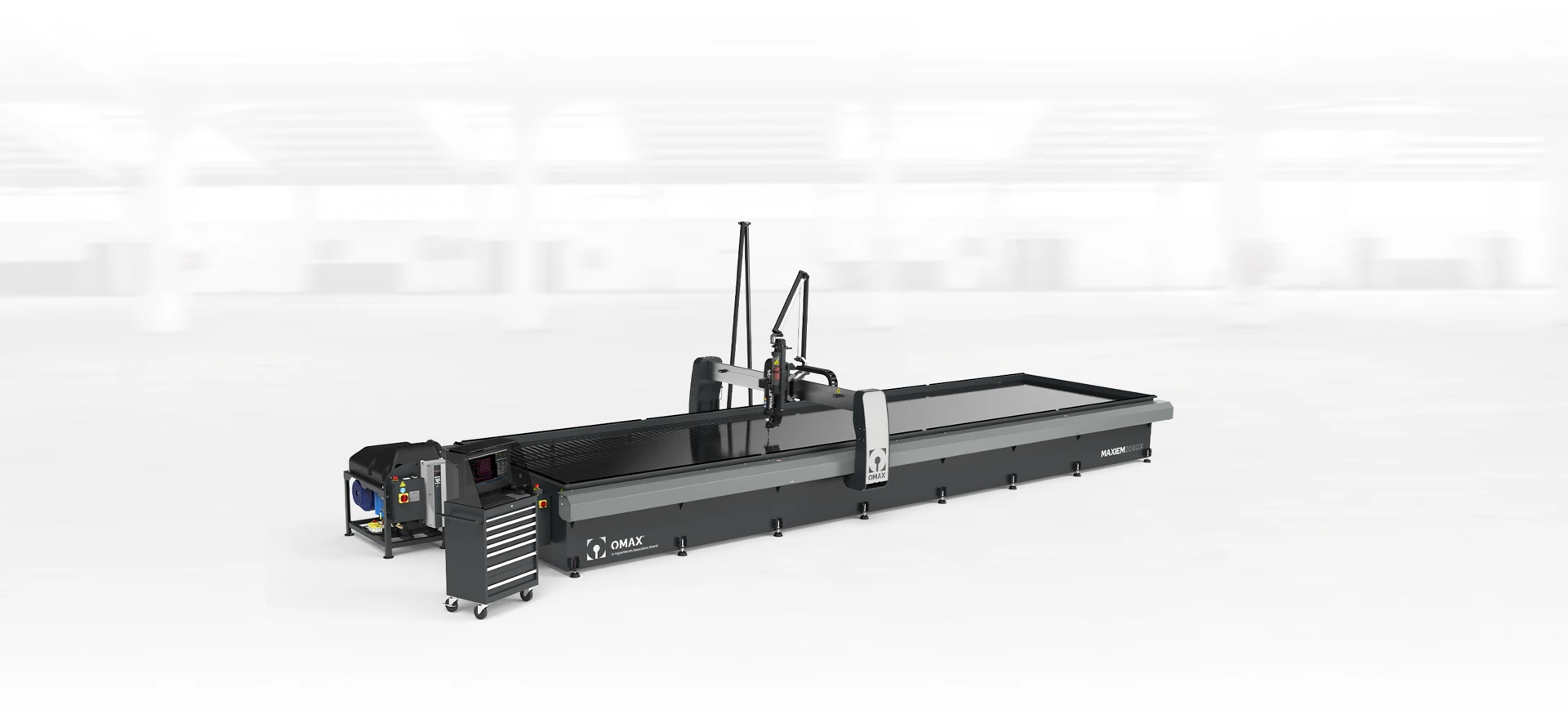

MAXIEM 2080X
Jetmachining Center
MAXIEM 2080X Abrasive Waterjet
Features
  • IntelliVISOR Mobile puts machine monitoring in your hand allowing you to review status, get notification and remotely pause operations. Available on IOS and Android.
  • 1 year of free training
  • 1 year / 2000-hour limited warranty
Dimensions & specs
Machine Dimensions/Envelope
Footprint (with pump & controller) 35′15″ x 12′ 11″ (10.69 m x 3.94 m)
Height (with scissor plumbing) 10′ 4″ (3.15 m)
Operating Weight 50,123 lb (22,735 kg)
Weight (tank empty) 12,800 lb (5,806 kg)
X-Y Cutting Travel* 27′ 2″ x 6' 7″ (8.28 m x 2.00 m)
Z-Axis Travel (with Motorized Z Axis)* 12″ (304 mm)
Table Size 27′ 10″ x 7' (8.48 m x 2.13 m)
Model Specs
Material Supports Slats 4″ x 14 Gauge Galvanized Steel (102 mm x 2 mm)
Maximum Supported Material Load 300 lbs/sq ft (1,465 kg/sq meter)
Speed 500 in/min (12,700 m/min)
Linear Positional Accuracy* ±0.003″ (±0.076 mm)
Repeatability* ±0.001″ (±0.025 mm)
