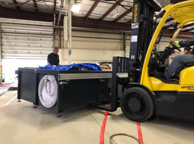

Scheduling Forklifts
Waterjet catcher tanks are heavy, so a forklift will be necessary to unskid and move your waterjet into the prepped floor space. Review the lifting requirements for your particular machine and have a forklift with a certified operator available when the technician arrives at your facility.
The technician will remove the blue protective wrapping from your machine tank before preparing the removal of the pump and bridge using the forklift along with straps or slings. Once the tank is emptied, it’s time to remove it from the shipping skid and place it in its new home.
Once you and the technician are happy with the machine’s location, the tech will level the tank to the floor to ensure the most accurate cutting. Once leveling is completed, it’s back to the forklift to install the gantry, or bridge, onto the linear drive rails. A second person from your shop will be needed to help guide the gantry into place.
