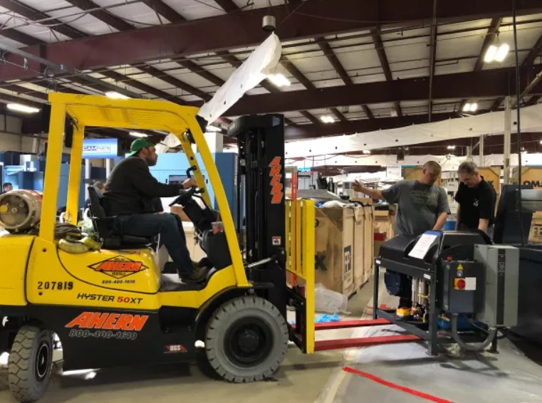

Adding a new waterjet to your shop is exciting. You can hardly wait to get your new machine up and running so you can expand your manufacturing processes. But before installation begins, you need to prep your space and do some housekeeping in order to make the process as quick and easy as possible. In this 2-part series, we'll take a look at process in installing a new OMAX Abrasive Waterjet.

Once electrical, water, and drainage systems are prepped and ready to go, you need to check the floor in the location your waterjet will be located. A completely level floor will ensure the highest accuracy and repeatability in cutting. Even if your floor looks level, many floors are off by between a half inch and an inch and a half. If your machine level is off by more than an inch, imagine what part tolerances will look like as the cutting head moves up and down that incline.
Not only will an unlevel floor throw off your tolerances, it could potentially warp your tank and twist your drive systems when water is added. One gallon of water weighs approximately 8.3 pounds, and a 5' x 10' cutting tank holds more than 1,500 gallons, which amounts to over 13,000 pounds. Laser your floor to determine the leveling point, or at the very least, take a large level and determine the high and low points.
Once you have mapped out the low points of your floor, use epoxy to even out the area and bring it as close to level as you can. Be sure to give the epoxy enough time to dry and cure before the machine is put in place.
