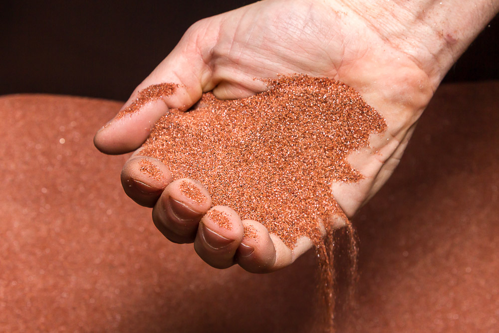

If you run an abrasive waterjet, garnet is not a small line item. It shows up on every invoice, in every catcher tank, and eventually in every disposal bill. So the question keeps coming back around: should we recycle it in house?
The honest answer is that it depends, and probably less on your machine than on your operation.
Recovery Is Not the Same as Reuse
Pulling garnet out of the tank is easy. Turning that garnet back into a reliable cutting medium is not. During cutting, garnet particles fracture, lose mass, and shift into smaller size ranges. Research on abrasive behavior has measured mean garnet particle size dropping by more than half after a single pass through the cutting head. Higher operating pressure tends to make it worse, not better.
What comes out of the tank is a mixed stream of usable particles, fines, moisture, and whatever came off the workpiece. Some of that stream can go back to work. A lot of it should not. Recovered weight is not the same as recovered cutting value.
