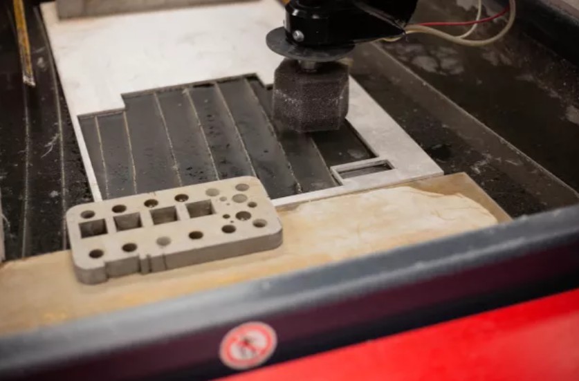

Using Drop Slats
While we’re discussing slats, have you ever considered using drop slats? Drop slats have a section that is several inches lower than the standard slats. This allows operators to more easily cut one side of a three-dimensional piece or cut thick materials underwater.
In the video, a ProtoMAX is cutting one side of a 4” square box. Each side of the box is made of 0.125” steel. By using the drop slats, the ProtoMAX can cut the side of the box regardless of the machine’s z-height. Please note that when cutting a 3D piece, like the box depicted in the video, you may want to add sacrificial material inside the box to prevent the the jetstream from cutting the other side.
Learn more and download the DXF file, which includes a simple drop slat drawing. The LAYOUT file can be adjusted to fit your own machine’s specifications.
