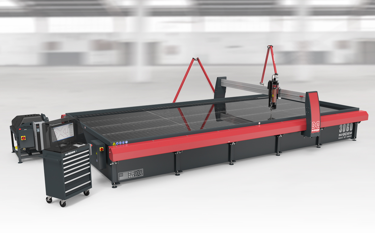

Maximum Reach, Minimal Limits. With a wide-format table and multi-axis capability, the 3060X is ideal for complex, high-volume jobs.
  • Cutting envelope of 20' 6" x 10' 2" (6.24 m x 3.09 m)
Expand all
  • IntelliVISOR Mobile puts machine monitoring in your hand allowing you to review status, get notification and remotely pause operations. Available on IOS and Android.
  • Designed and manufactured at the OMAX factory in Kent, Washington, USA
DIMENSIONS & SPECS
Footprint (with pump & controller)28' 6" x 16' 6" (8.69 m x 5.03 m)
Height (with scissor plumbing)8' 10" (2.69 m)
Operating Weight70,105 lb (31,799 kg)
Weight (tank empty)26,000 lb (11,793 kg)
X-Y Cutting Travel*20' 6" x 10' 2" (6.24 m x 3.09 m)
Z-Axis Travel (with Motorized Z Axis)*12" (304 mm)
Table Size22' 9" x 10' 8" (6.93 m x 3.25 m)
Material Supports Slats4" x 14Ga Galvanized Steel(102 mm x 2 mm)
Maximum Supported Material Load300 lbs/sq ft (1,465 kg/sq meter)
Speed500 in/min (12,700 mm/min)
