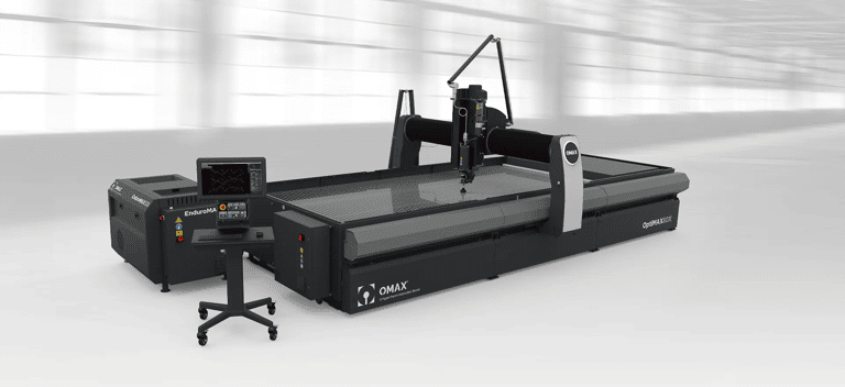

OptiMAX 80X Series
Precision Jetmachining Center
OptiMAX 80X Precision Jetmachining Center
Features
  • Exclusive IntelliTRAX abrasive jet linear drive system provides 350 in/min (8.9 m/min) traverse with real-time closed-loop positioning feedback
  • 12-inch (305 mm) programmable Z axis travel with lowest ceiling height requirement design in the industry.
Dimensions & specs
Machine Dimensions/Envelope
  80X 80X-1
Footprint (with pump & controller) 26′ x 12′ 11″ (7.92 m x 3.94 m) 32′ 8″ x 13′ 5″ (9.96 m x 4.08 m)
Height (with Scissor plumbing) 10′ (3.05 m) 10′ (3.05 m)
Operating Weight 49,575 lb (22,487 kg) 65,900 lb (29,892 kg)
Weight (tank empty) 9,150 lb (4,150 kg) 12,430 lb (5,638 kg)
X-Y Cutting Travel* 13′ 4″ x 6′ 8″ (4.06 m x 2,03 m) 20′ x 6′ 8″ (6.09 m x 2,03 m)
Z-Axis Travel (with Motorized Z Axis)* 12" (304 mm) 12" (304 mm)
Table Size 15′ 1″ x 7′ 2″ (4.60 m x 2.18 m) 21′ 9″ x 7′ 2″ (6.63 m x 2.18 m)
