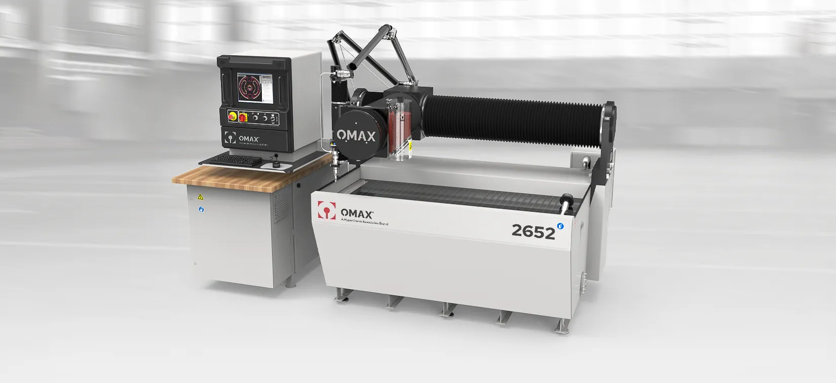

OMAX 2652
Precision Jetmachining Center
OMAX 2652 Abrasive Waterjet
Features
Standard Features
  • Backed by OMAX’s exclusive IntelliMAX Premium Software
  • Robust and accurate design for tight tolerance cutting and reliable operation
  • Pre-loaded linear bearings and precision ball screws
  • Shipped as a completely pre-assembled and factory-tested system
  • Standard scissor-style hard plumbing adds another level of safety by using contained high-pressure components, as well as contributes to a smaller footprint, lower maintenance, and higher reliability
OMAX Benefits
Service & Training
Dimensions & specs
Machine Dimensions/Envelope
Footprint (with pump & controller) 12′ 1″ x 6′ 3″ (3.68 m x 1.91 m)
Height (with SCISSOR plumbing) 8′ (2.44 m)
Operating Weight 10,252 lb (4,650 kg)
Weight (tank empty) 4,300 lb (1,950 kg)
X-Y Cutting Travel* 4′ 4″ x 2' 2″ (1.32 m x 0.66 m)
Z-Axis Travel (with Motorized Z Axis)* 8 (203 mm)
Table Size 5′ 9″ x 2' 6″ (1.75 m x 0.76 m)
