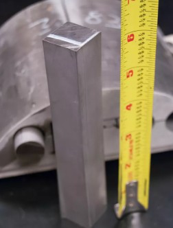

Myth:
Waterjets are only good for cutting thin materials.
Fact:
Modern waterjet systems are optimized to cut materials between ¼ inch up to 3 inches thick. Given enough time and consideration for taper, waterjets can cut as thick as you want.
Maintaining Control
Since water wants to return to its natural state, the jet will degrade and begin to thicken so it is narrower at the top and thicker at the bottom. The thicker the material, the more control and understanding of the jet is required. Jet stabilization is key for cutting thicker materials.

The material itself plays an important role in stabilizing the jet. In abrasive waterjet cutting, the material acts as an extension of the tool tip. Once the material catches the jet, the jet begins to stabilize. Thicker material allows for more time for the waterjet to stabilize. Denser materials also hold the jet better and allow for more stabilization.
To ensure you have a good, stable stream going into your material, you must have a proper stand-off. The recommended stand-off based on your nozzle and mixing tube combination should always be followed for the best jet quality. Too high of a stand-off and you will have poor edge quality and a less stable jet; too close and you will risk nozzle clogs.
The longer you can keep the jet stable, the thicker you can cut. Modern waterjet systems use a combination of hardware and software components to assist in predicting the optimal jet. Dense and /or thick materials also play a role in keeping the jet consistent and stable compared to thinner materials and can be more efficiently cut on waterjet.
