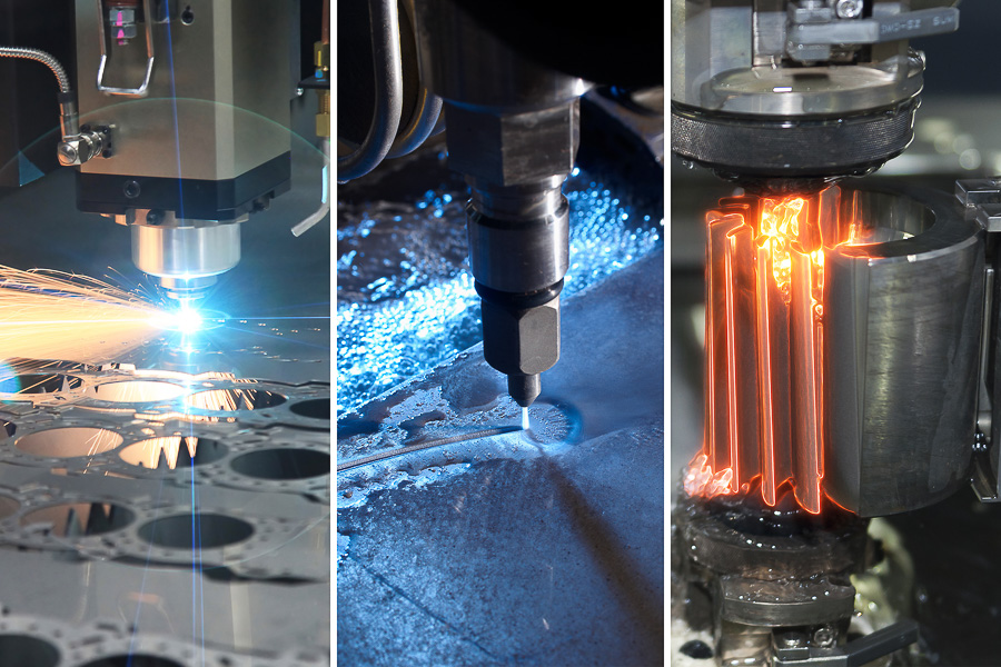

Picture a job that lands on your bench: a one-inch titanium bracket, tight tolerance requirements, and a delivery date that leaves little room for rework. Do you cut it on an OMAX abrasive waterjet cutter, a laser, or wire EDM? The right answer depends on material, thickness, tolerance, heat sensitivity, edge quality, and production volume. This article compares abrasive waterjet, laser, and wire EDM on the specifications that decide the job, including accuracy, heat-affected zone, thickness range, kerf, edge quality, cutting speed, and cost per part. The waterjet vs laser cutting and waterjet vs EDM machining questions rarely have one universal answer. The goal is to match each process to the part in front of you.
Choosing Between Waterjet, Laser, and EDM
Every cutting process trades one strength for another. Wire EDM holds the tightest tolerances, but only on conductive metals and usually at slower speeds. Laser moves fast on thin, flat, non-reflective sheet, but it brings heat into the cut. Abrasive waterjet covers the widest range of materials and thicknesses without adding heat to the part.
The best process depends on the part, but the variables that make cutting jobs difficult, including mixed materials, thicker stock, reflective alloys, and heat-sensitive edges, are the same variables that often favor an OMAX abrasive waterjet. A shop running thin aluminum sheet at high volume may still choose laser. A shop finishing ultra-tight conductive features may still choose EDM. For changing job-shop work, waterjet usually gives you the broadest first move.

How Each Cutting Process Removes Material
Understanding the physics of each process explains most of the tradeoffs. One erodes with abrasive-laden water, one uses focused heat, and one uses electrical sparks.
Abrasive Waterjet Cutting
An OMAX abrasive waterjet uses a high-pressure stream of water to erode a narrow line in the material. The machine consists of three basic components:
  • The table:  X-Y table with a nozzle, a garnet hopper, and a catcher tank below.
  • The pump: a high-pressure pump that provides pressurized water for the cutting process.
  • The controller: software that manages system operation, motion control, and nozzle positioning.
Because the abrasive is introduced directly into the cutting stream, an OMAX abrasive waterjet can handle a wide range of materials and thicknesses on the same platform. That flexibility lets one system move from thin stock to thick titanium brackets without swapping processes.
Laser Cutting
Laser cutting is a thermal process. A focused beam melts, burns, or vaporizes the material along the cut line. The laser source can be gas-based, such as CO2, or solid-state, and either the beam or the material moves during the cut.
Thickness is where laser shows its limit. The general laser ceiling is around 0.25 inch, although some higher-power systems can reach 30 to 40 mm. Treat these as two data points: laser stays efficient on thinner stock, with capacity varying by machine power.
That makes laser the right answer for some production work, but not all production work. Once the job moves into thicker stock, reflective metals, or parts that cannot tolerate heat at the edge, the case for abrasive waterjet gets stronger.
Wire EDM
Wire EDM is a spark-erosion process. An electrical arc rapidly discharges between the wire electrode and the workpiece, and the series of arcs melts and vaporizes the material, with debris flushed away by dielectric fluid.
That mechanism carries one hard constraint: EDM works only on electrically conductive materials. Within that limit, EDM excels at intricate features in hardened metals that are difficult to machine by conventional methods. It is a precision tool first, which is why it often makes more sense after the broader profile has already been cut.
