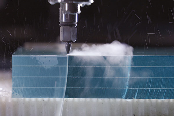

Waterjet cutting glass

First, if possible always pierce off the part. Place lead-ins and pierce points in scrap areas whenever possible. The initial impact of the jet can create localized fractures. Keeping that away from your finished edge is critical.

Low-pressure piercing is non-negotiable. Start the piercing at reduced pressure, then ramp to full pressure for the cut. This soft entry reduces the hydraulic shock that causes cracking.
Timing between water and abrasive also matters. You want abrasive present as the stream hits the material. A delay where pure water hits first can fracture the surface before cutting even begins.

Use Sacrificial Backing Material
Glass needs support during both piercing and cutting. Without it, the exit side of the cut can chip or blow out.
Place a sacrificial layer under the glass. Common options for sacrificial material include Jet Brick, wood and cardboard. This backing absorbs jet energy as it exits and supports the material against deflection. The concept is the same as supporting thin sheet metal. Without backing, the material flexes and edges degrade.

One of the biggest is attempting to cut tempered glass. Tempered glass is internally stressed by design. Any attempt to pierce it releases that stress instantly and causes the panel to shatter. Only cut annealed, laminated, or untreated glass on a waterjet.
