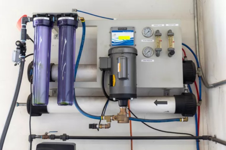

As with any machine, some preventive maintenance is required – including routine water treatment. Filtration and water softeners solve many inlet water issues, and in areas where TDS exceeds 250 ppm, reverse osmosis systems can remove up to 90 percent of the solids for pure, clean water supply into the equipment.
