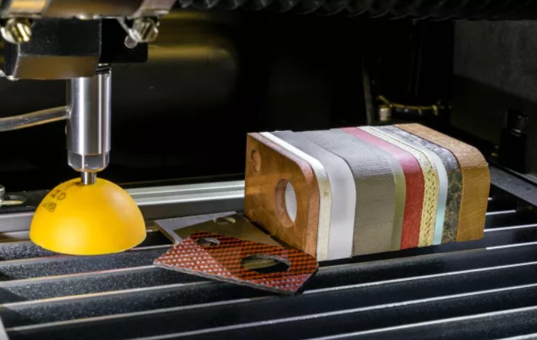

In terms of types of material cut, an abrasive waterjet is the most versatile cutting method available. Where EDM specifically cuts conductive substances, and laser is limited to non-reflective materials, abrasive waterjet cuts virtually every material available. OMAX machines are currently being used to cut stone, brass, carbon steel, glass-refined plastics, and so much more. With abrasive waterjets, there is no need for special coatings or other considerations. Materials simply need to be fixtured into place. With abrasive waterjet, the cut product has no heat affected zones (HAZ) or material distortion, often removing the need for secondary machining.
In addition, abrasive waterjet is pushing the extremes of micro and macro machining. OMAX’s MicroMAX JetMachining Center is capable of a positioning accuracy within five microns and is being used for extremely small precision customization in the defense and tech industries. Using the same technology, the OMAX 120X series, offered with a customizable cutting bed that can reach up to 40 feet by 10 feet, is being used in large tank fabrication as well as architectural metal and glass. The size of the finished product is only limited by the size of the waterjet’s cutting table, allowing a manufacturer to work as small or as large as needed without additional specialty equipment.
Switching between materials is as fast a placing a new material on the cutting bed. An abrasive waterjet is capable of cutting aluminum one minute then switching out to cut foam rubber the next. What if a fabrication shop client asks for a prototyped part in titanium, then also asks for a gasket to accompany it? Depending on the programming time of the part needed, it isn’t out of the question to have the entire project wrapped up in one day, employing one person, on one abrasive waterjet.
