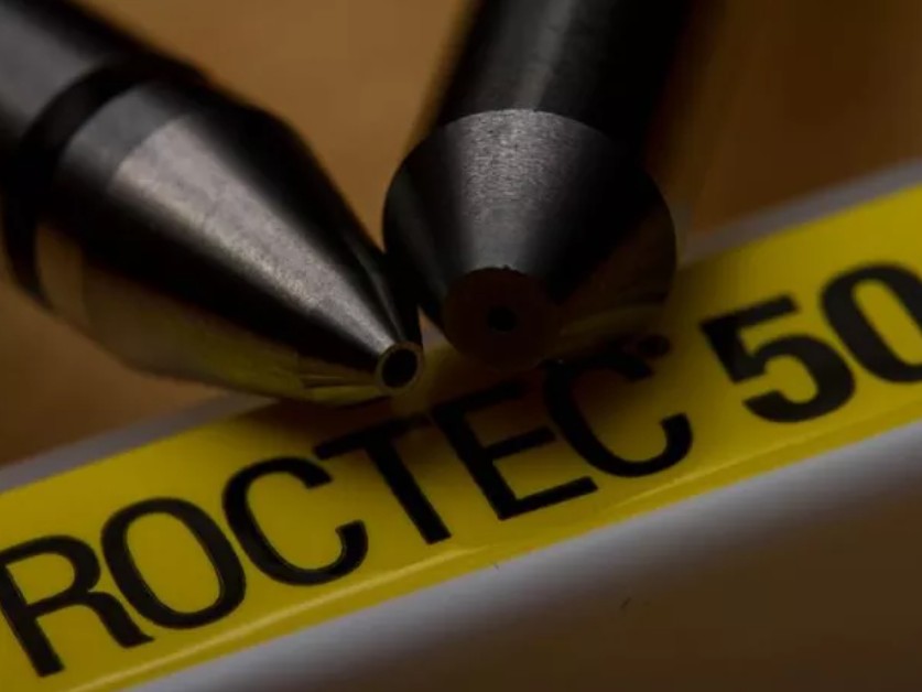

Mixing Tubes
We use high-pressure water and abrasive in waterjets to cut nearly any material with the utmost efficiency. The mixing tube where the garnet and water meet also wears away gradually, forming an irregular orifice that creates a less-accurate stream. Furthermore, misaligned jets, damaged jewels or contaminated garnet abrasive can damage the relatively fragile mixing tube. Keep a few spare mixing tubes on hand so you can quickly switch out broken or damaged tubes and get right back to machining.
