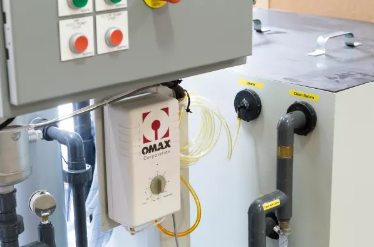

The third option is to install an OMAX Water Recycling System. The OMAX Water Recycling System is designed to capture the workable overflow water for recycling to the proper specifications, then returning the water back to the high pressure pump. A filtration system traps suspended particles and ensures that high quality water feeds to the high pressure pump. An ozone generator is used to reduce bacteria growth. The water recycling option has the added benefit of being ISO 14000 compliant. The system can help a company comply with environmental management requirements and waste authority disposal regulations.
