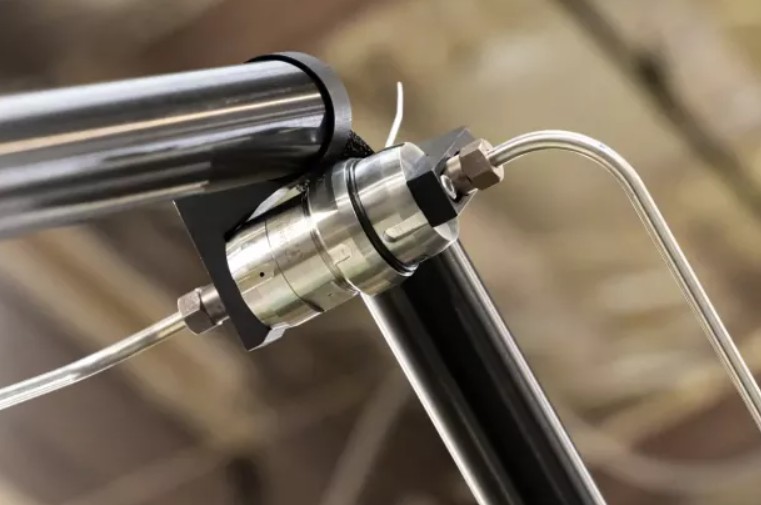

What is Scissor Plumbing?
Scissor plumbing is a flexible and dynamic arrangement of high-pressure lines within a waterjet cutting system. It allows for movement along multiple axes without restricting water flow or abrasive. In essence, it is a design solution that accommodates the cutting head's complex motions while maintaining a steady and uninterrupted supply of high-pressure water, often exceeding 50,000 PSI (pounds per square inch).
In a waterjet system, the cutting head moves across the cut material, following intricate paths dictated by the operator or pre-programmed designs. The plumbing must be flexible enough to move with the cutting head and durable enough to handle the extreme pressures and abrasives used in the cutting process. Scissor plumbing is specifically designed to solve this challenge by using a folding, extendable design that adapts to the movement of the machine.
