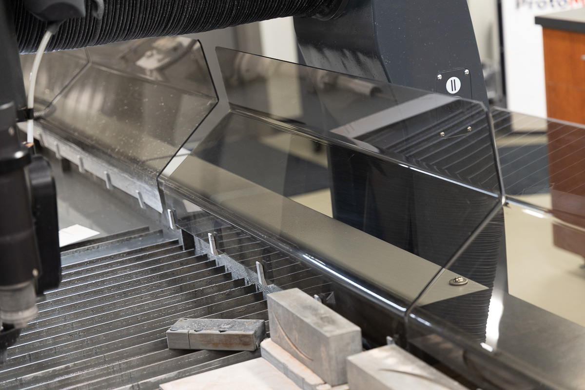

image of splash shield on MAXIEM

1. Control Splash at the Source with a Nozzle Guard
Piercing is one of the most common causes of splash. The initial breakthrough pushes water and abrasive upward, often outside the immediate cutting area. Piercing between slats can reduce the water spray.
A nozzle splash guard, or muff, addresses this directly. It fits over the nozzle keeping spray localized and preventing it from reaching operators or surrounding equipment.
2. Extend Containment with a Splash Shield Kit
For a more integrated approach, splash shield kits provide perimeter control. These clear, panels mount around the tank and effectively extend the tank walls upward.
Because they are segmented, operators can remove only the sections needed for loading or part retrieval, then quickly reinstall them before cutting resumes. This keeps workflows flexible while maintaining protection during operation.
These kits are available across MAXIEM and OptiMAX platforms, scaling easily from smaller systems like the MAXIEM 1515X up to larger formats such as the OptiMAX 80X or MAXIEM 3060X.
