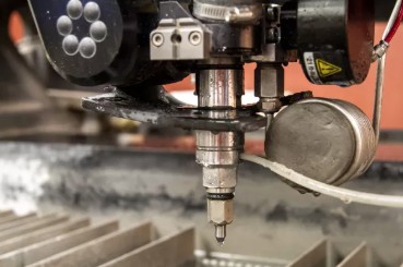

The terms nozzle and mixing tube are often interchanged when people are talking casually about waterjets. A nozzle is the whole assembly where the water is focused through an orifice, abrasive is added to the jet stream in a mixing chamber, and the combined mixture is focused and extruded from the machine. The mixing tube is the last part of the nozzle that concentrates and directs the water/abrasive mixture.
ROCTEC mixing tubes are made of a tungsten carbide-based material. Although the mixing tube is made from an extremely hard material, with time the flow of high-pressure water and abrasive will wear away the mixing tube. This causes a gradual widening of the mixing tube, which results in a wider, less accurate stream of abrasive and water. It is because of this that OMAX recommends rotating the mixing tube a quarter turn every eight hours of cut time.
The mixing tube should be replaced when tolerances drop below acceptable levels. For maximum accuracy, replace the mixing tube more frequently. The size of the kerf and cutting performance are the best indicators of mixing tube wear. Please read here on further information on kerf and how it affects cutting performance.
