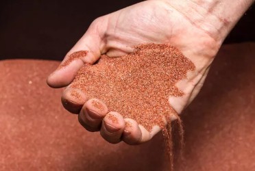

Image of garnet abrasives
There are many different kinds of abrasives including garnet, staurolite, olivine, crushed glass and copper slag. There are also different brands, grades and sizes of abrasives. Garnet is the most popular abrasive for abrasive waterjet applications because it balances cutting speed, cost, low silica content and mixing tube wear.
