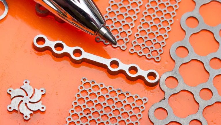

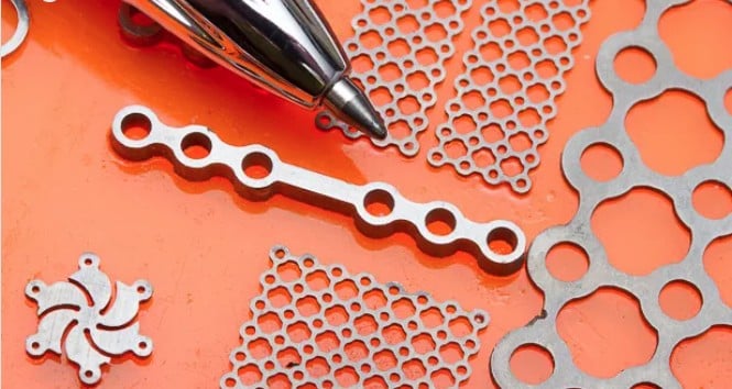

Manufacturers of medical components are increasingly taking advantage of abrasive waterjet machining. It’s a versatile, accurate process that matches many medical partmakers’ needs while offering some capabilities that are unavailable from other machining processes. These manufacturers opt for waterjet machining mainly because it does not create a heat-affected zone that can compromise part performance.
Image of medical Shop image
Additionally, medical applications often involve small, complex parts that can be difficult to clamp and hold steady against force generated during conventional machining. Waterjet cutting exerts practically zero force on the part being cut, reducing fixturing challenges to keeping clamps (if any are necessary) out of the cutting path. Waterjet machining’s ability to cut essentially any material is also a significant factor when considering the continually broadening range of workpiece materials utilized in medical components.
A waterjet can cut metals from steels to nickel-base alloys and non-metallic workpieces including carbon fiber, PEEK, graphite, composites, laminates and more. Reflective and non-conductive materials that pose challenges for laser and EDM machining are not a problem for a waterjet machine.
One example of a particularly challenging medical material successfully cut on a waterjet machine is the nickel-titanium alloy known as Nitinol. Called “memory steel,” it is flexible and can be bent and formed to acute shapes, but it also is formulated to return to its original shape when heated. Medical component manufacturers use the alloy to make parts like self-expanding vascular stents. The stents are compressed so they can be inserted into a blood vessel, then expand to their original shape to support the vessel when exposed to the 37˚C temperature of the human body.
For many Nitinol applications laser or conventional machining methods are not effective. Waterjet machining enables intricate stent designs to be cut from flat stock and then rolled into cylinders to fit inside a blood vessel. Even with very finely detailed parts, waterjet machining can eliminate conventional machining problems such as edge chipping and burrs that are problematic in medical parts.
