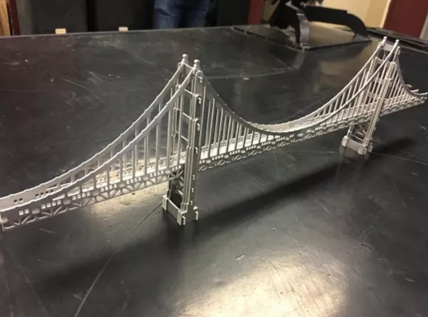

The best file type to use with the OMAX Software
Image of a scale size bridge
The text version of Release 12 AutoCAD DXF is the file format that works best with LAYOUT. "Explode" all entities that LAYOUT should see so they are simply lines and arcs. Typically, this is performed from AutoCAD using the "explode," and "dxfout" commands.
