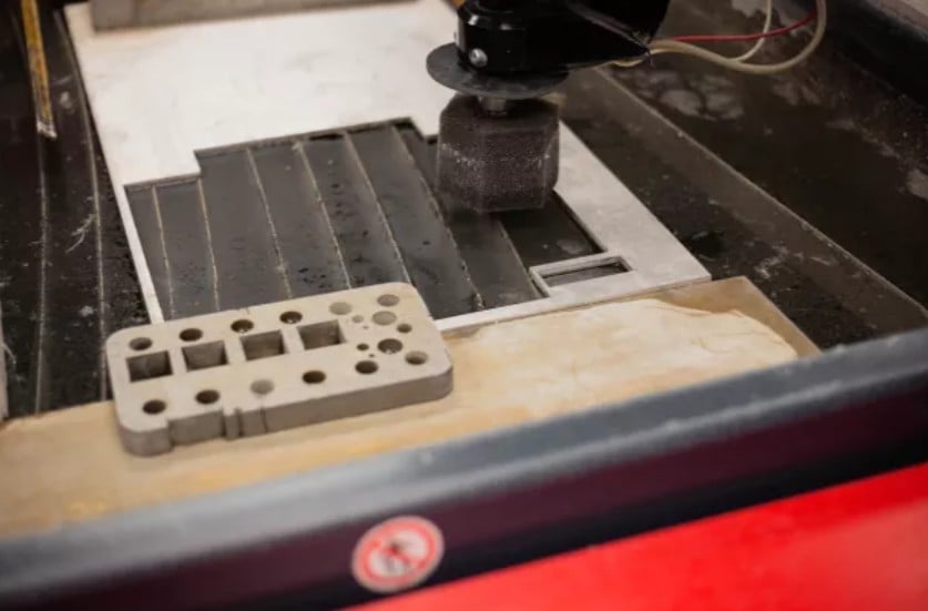

Slats are the stainless steel plates that support the material being machined in an OMAX abrasive waterjet. They are the best, most universal solution for supporting material. The standard slats that come with your OMAX waterjet can easily handle everything from metal plate and glass to stone and plastic, as well as nearly any other material.

Waterjet users tend to place parts to be cut on one part of the table. For example, you may routinely cut in the bottom left corner of the table because it is nearest to the waterjet’s controls. As a result, slats will develop uneven wear over time, which may cause your material to rock on the slats during machining. This rocking will dramatically reduce the precision of your OMAX waterjet.  To ensure accurate cutting, it is important to maintain your slat bed.
