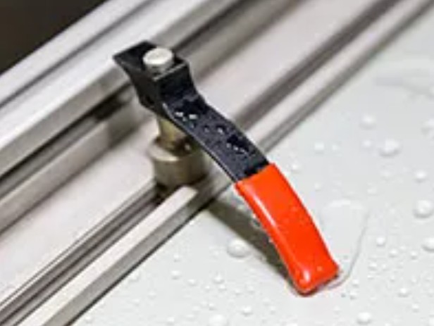

Why use fixturing?
Fixturing refers to holding work material in place while the waterjet cuts parts from it. For most jobs, it's critical that the material doesn't move during cutting, as any movement will affect the precision of the part and can mar the surface. Compared to other cutting methods, the sideways forces of abrasive waterjet cutting are low and the downward force is concentrated to a small area. What many new waterjet operators are unaware of is that the jet drives a significant amount of air into the catcher tank that causes the water to bubble under the workpiece. That bubbling can easily lift the material and move it sideways.
One great advantage of machining with an abrasive waterjet is that fixturing flat plate or sheet material is quick and easy. You should always fixture in the X, Y, and Z directions with enough force that the part cannot wiggle. You can test this by trying to move the workpiece by hand. If you can move it at all, then it needs more fixturing.
Fixturing made specifically for OMAX Waterjets
A Material Holding Kit will keep your material secure for high precision cutting. The kit includes track assemblies and vertical load clamping arms. It mounts into the waterjet slat bed and is customized to fit your exact OMAX or MAXIEM machine dimensions. You can purchase the Material Holding Kits at the OMAX Marketplace. Note that even when solidly clamped along the edges, a lightweight material can be lifted by the jet action. Placing steel weights on lightweight material helps prevent lifting.
