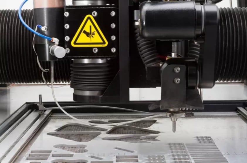

It is often asked "how fast is a waterjet?"
OMAX waterjets are faster than many cutting machines on the market. Exactly how fast depends on a number of factors. Power, material, thickness and more need to be considered when determining how long a finished piece will take to cut. For example, tool steel will have a different cutting time than titanium. The following are the main factors that affect the speed of OMAX machines:
Power of the Pump
Double the horsepower of the pump, and the cutting speed will dramatically increase. Horsepower determines how much water is actually flowing through the waterjet’s nozzle. Think of a 30 hp pump as a garden hose, and a 100 hp pump as a fire hose. If the goal is to move as much water as possible, efficiently, thereby inducting the abrasive into the stream and cutting, then the fire hose is going to be faster.
To learn more about how pumps affect your cutting speed, check out this article in the FABRICATOR.
Image showing factors of speed in waterjet cutting

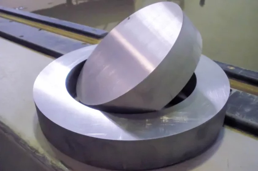

Desired Surface Finish
Image of factors of speed in waterjet cutting 2
The higher the quality of a part’s surface finish after cutting, the longer it will take to make the piece. Due to its precision and high cut quality, many fabrication shops use their waterjet as a single-stop tool. This means the parts that come off the waterjet are ready for use without any secondary machining.
To save time, several manufacturers aim for lower quality surfaces because they plan to cut near-net shapes. Integrating this near-net shape cutting into processes significantly reduces production time. An abrasive waterjet can handle large sheets of raw material and cut multiple blanks with very little setup and fixturing time. Abrasive waterjets can easily cut material that’s difficult to machine on a CNC mill, such as Inconel®, Hastelloy® and titanium, and there’s no need to change tooling to cut different types of material.
