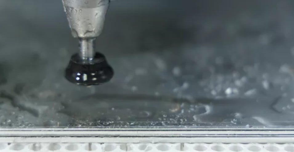

When cutting a lot of very thin parts, stacking the material may be beneficial, especially if there is a lot of rapid traversing or workpieces that require time-consuming fixturing. Some of the benefits of stacking are that it cuts down on setup time for very thin materials and can reduce the amount of rapid traversing per part. Stacking may also reduce taper and the amount of burr remaining on the workpiece’s bottom edge.
