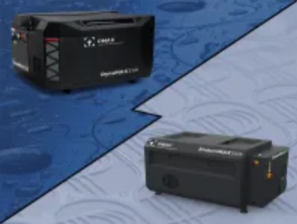

OMAX builds two pump families: The EnduroMAX direct drive pump, and the DynaMAX intensifier. Each one fits a different style of work. The differences are not complicated, but they matter in day-to-day production.
When an EnduroMAX Makes Sense
The EnduroMAX is designed for shops that rely on abrasive cutting for most of their work. It produces continuous pressure up to 60,000 psi and is built to run for long periods between rebuilds. The design uses independent cylinders, which makes service straightforward and keeps downtime short. Direct drive pumps convert more of the motor’s energy directly into water pressure. This efficiency shows up in the cut.
For job shops that need to hit tight turnaround times or run mixed materials through the day, the EnduroMAX helps keep things moving with a simpler design and maintenance requirements over other styles of pumps. Shops that run steel, aluminum, composites, and plastics throughout the week see clear benefits from the way a direct drive pump delivers pressure.
When a DynaMAX is the Better Fit
The DynaMAX family uses intensifier pump technology. Intensifiers rely on hydraulic pressure to create a very stable, consistent water stream. This type of pump performs well in situations where abrasive is not needed, and water only is the priority. Foam, rubber, gasket materials, and food products are common examples.
Intensifier pumps also handle multiple cutting heads. They can support setups where two or more nozzles cut from the same pressure source. Shops that run long continuous cycles or unattended jobs often prefer the steady pressure of an intensifier. Intensifier pumps can require additional maintenance due to the more complex system and stored attenuator pressure, but the tradeoff is the type of pressure delivery that certain applications depend on.
