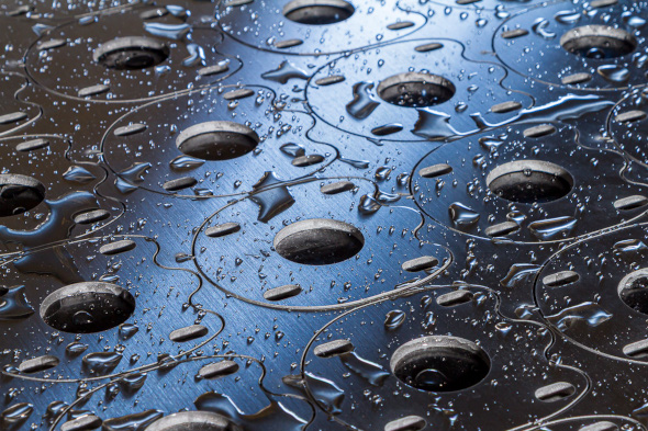

Material Savings Through Near‑Net‑Shape Cutting
Material savings through near‑net shape cutting come from removing excess material early in the process. By cutting parts close to final geometry, manufacturers reduce scrap, improve sheet utilization, and eliminate unnecessary roughing. This protects material margins, shortens cycle times, and lowers total cost per part.
Tighter Nesting and Less Scrap
The narrow kerf of OMAX waterjets allows tighter nesting, improving material yield from each sheet or plate. This becomes especially important when cutting expensive materials.
Eliminating Secondary Operations
Waterjet cutting is a cold process meaning it doesn’t impart heat to the cut material. Parts leave the table flat, stress‑free, and burr‑free. In many applications, this eliminates secondary machining, grinding, or stress relief, saving time, labor, and machine capacity downstream.
