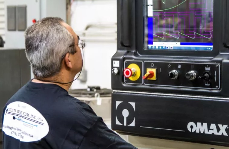

Image of user looking at software on a screen
